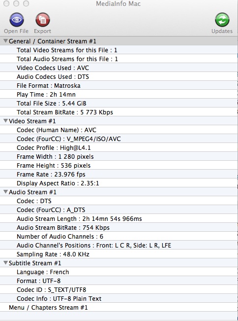

Here is the log in trace mode.
When I try to play the movie through UMS, UMS decode it and noting appears on the TV screen. He's all black.
I can read it without problem from an USB key.
UMS try to transcode with ffmpeg.
Here is also a screen capture of MediaInfo.
Not OK.jpg (126.04 KiB) Viewed 9806 times
How can I just say to never transcode anything or some extensions (mkv, avi, ...)
Thank you for your help

The video is transcoded because it has embedded subtitles. You can go to the TRANSCODE folder and choose the [No Transcoding] for the video and test it.
