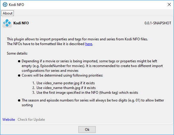

@mediamelt I'm done with a first version you can try. It can be downloaded from here (code); just place the jar in the plugins folder.
Some notes:
- NFOs for movies and series are supported (tested with the ones you've attached).
- Only the NFOs having the same name as the video file (with *.nfo extension) will be used; tvshow.nfo is not being used.
- For now thumbnails are being downloaded from the web if a link is included in the NFO. I might change this, but currently there is no mechanism in place to pass a link to an existing file in the file system und just use it.
- Your NFOs got some bad encoding for special characters e.g. Umlauts; this has to be fixed/configured on the kodi side.
Give it a go and tell me what's missing :)

@mediamelt cool :) I've made some changes to support existing files for thumbnails (*-poster.jpg and *-thumb.jpg) as you've suggested. As this required changes in the mlx base code you'll have to install the full SANPSHOT build though. Additionally, the description in the about panel is now more descriptive. Btw if you want to contribute and localize the messages, you could translate the messages.

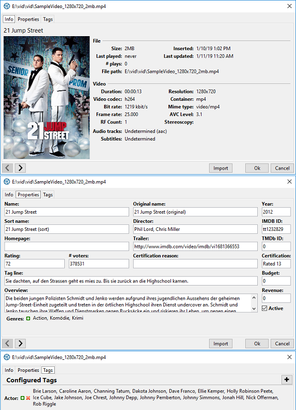

  • Example .NFOs - these are the reference .NFOs that work with KodiNfoImportPlugin.
UMS-MLX Library to NFO Mappings - Depending if <movie> or <series> is imported, some tags or properties might be left blank (ie, EpisodeNumber for movies)
<movie>
	- Name : <title>
	- Original Name : <originaltitle>
	- Year : <year>
	- Sort Name : <sorttitle>
	- Director : <director>
	- IMDB ID : <id>
	- Homepage : not mapped
	- Trailer : <trailer>
	- TMDb ID : not mapped
	- Rating : <rating>
	- # Voters : <votes>
	- Certification Reason : not mapped
	- Certification : <mpaa>
	- Tag Line : <tagline>
	- Budget : not mapped
	- Overview : <plot>
	- Revenue : not mapped
	? Active : ???
	- Genres : <genre>
	- Actor : <actor><name>
	x EpisodeNumber : n/a
	x FirstAired : n/a
	x Network : n/a
	x SeasonNumber : n/a
	x SeriesName : n/a
	x Writer : n/a
</movie>
<episodedetails>
	- Name : <title>
	x Original Name : n/a
	- Year : <year>
	x Sort Name : n/a
	x IMDB ID : n/a
	x Trailer : n/a
	- Rating : <rating>
	x Tag Line : n/a
	- Overview : <plot>
	? Active : ???
	x Genres : n/a
	- EpisodeNumber : <episode>
	- FirstAired : <premiered>
	- Network : <studio>
	- SeasonNumber : <season>
	- SeriesName : <showtitle>
	- Writer : <credits>
</episodedetails>

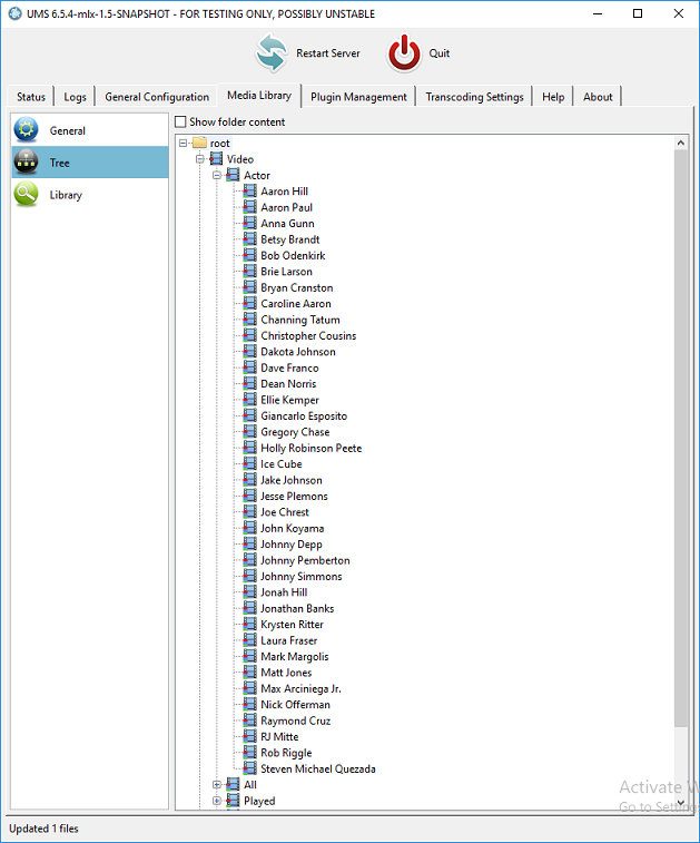

Screenshots - demonstrates an what the example NFO looks like with an AutoFolder grouped by Actor
