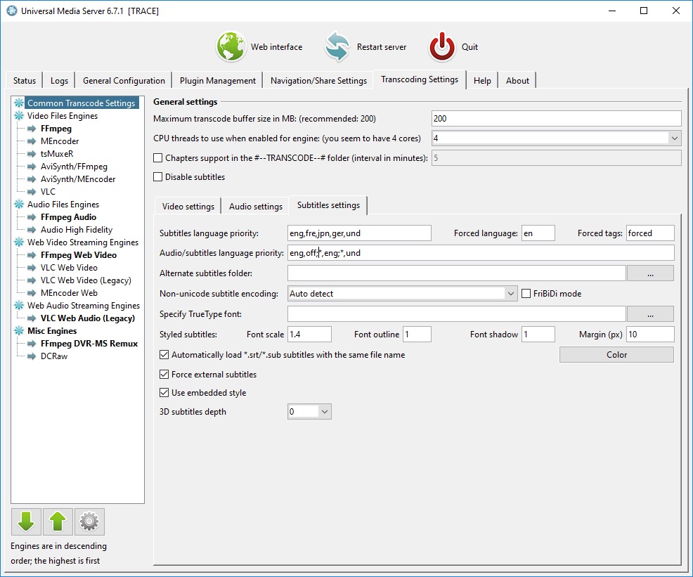

Attached is the way UMS 6.7.1 is currently configured.
Assuming subtitles are always in a sub-directory, called "subs" or "Subs", of the movie folder; and the sub files follow the format:
And assuming I'd want to use "English(SDH).srt" or "English.srt" (or is that chosen by the client/PS3?), what would I have to change in the config to enable client (PS3) controllable/on-demand subs?
From reading the tooltip I assume I'd have to remove the "eng,off;", but what else?
English(SDH).srt
English.srt
French.srt
etc...
- subtitles-config.jpg (192.81 KiB) Viewed 29699 times
Re: How do subtitles get put into the stream?
The PS3 doesn't support external subtitles, so the only way is to "burn them in" as part of the video. When it comes to the configuration, there's an explanation here.
When it comes to the naming convention for the subtitles files, I'm not familiar with that code. When taking a quick look at the code, it isn't very obvious exactly what it does, but it seems to me that the general idea is that the subtitles files should be named the same as the video file except the extension + the language code + the subtitles extension. Example:
From what I can see, this is the list of supported codes (both 2 and 3 letter codes are allowed):
Foo.avi
Foo.de.srt
Foo.en.srt
Foo.fr.srt
