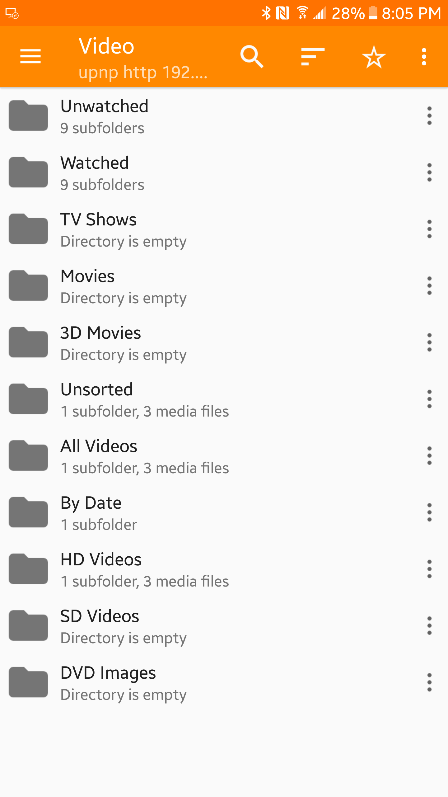

Yes, I have seen the "Media Library" Folder. And yes, I'm looking for something more advanced than what I think the native media library can offer. Just to make sure I'm not missing anything, attached are the default groupings I see. Is there any way to expand beyond these groupings, the A-Z option, and/or add custom categories?
As for suggestions, it would be fantastic to possibly build off of what UMS-MLX offers. Essentially, that infrastructure allows for an effective infinite number of dynamic groupings, custom categories. Also the ability to nest groupings is very powerful as well. Ie, you could replicate your entire dynamic structure (Genre, Director, Actor, etc) within a top-level "Favorites" group, or Actors within Genre, Genre within Actors, so on and so on.

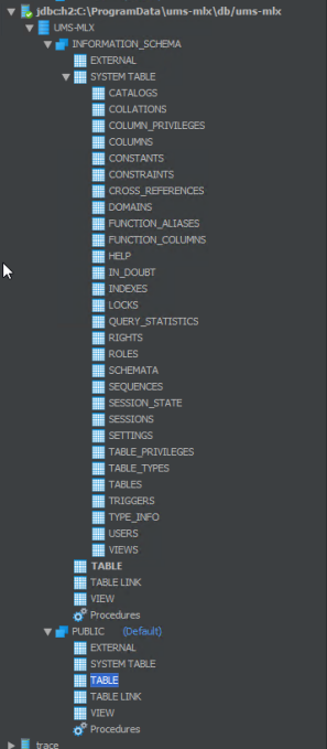

does anyone happen to have the JAR version of KodiNfoImportPlugin that taconaut built and references @ Subject: ums-mlx [2015-11-25 v1.4]? or is anyone able to guide me on how to build (compile?) my own from the GIT code? I really think this ability to build a library via .NFO would be a game changer. I tried taconaut's instructions to view the DB contents again today, as described @ https://github.com/taconaut/ums-mlx/wik ... rs#view-db and failed yet again. Has anyone out there tried this? I was able to connect to the ums-mlx.db.mv.db database just fine but I wasn'table to find any media library contents whatsoever. It looks like an empty shell of a DB without any tables. Either I'm doing something wrong or media library details are being stored elsewhere.
