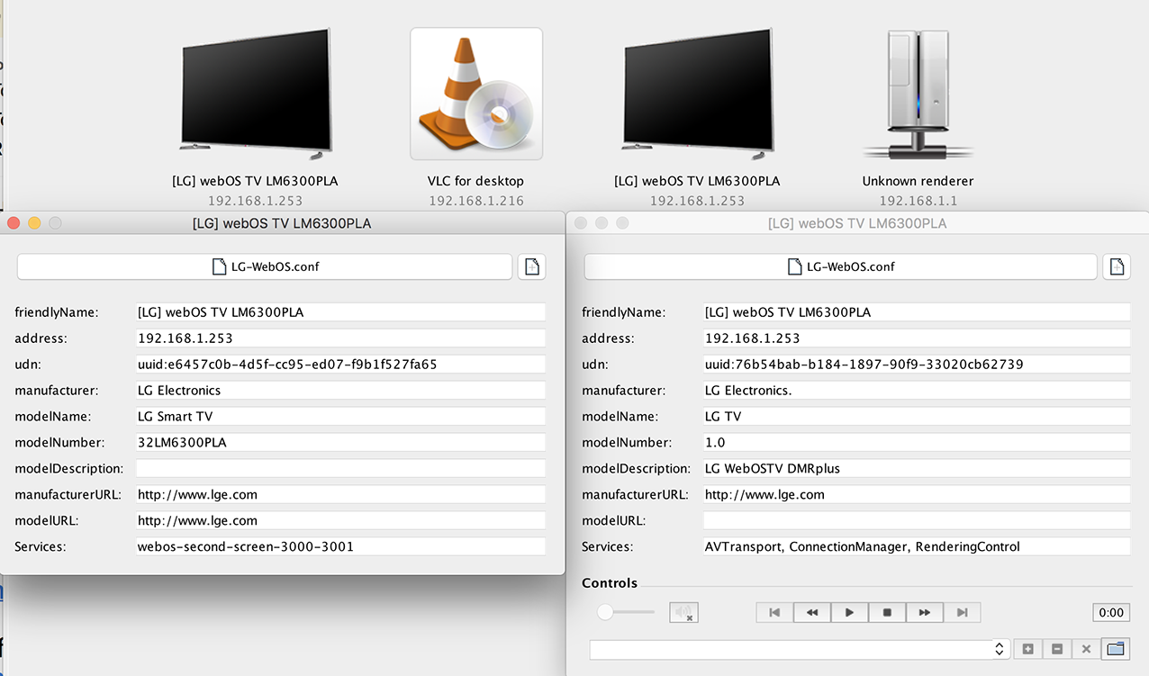

Thanks - I found your answer in another thread and I now have the settings. Now I need to find an idiot's guide to what looks like a minefield! But first I need to understand why my LG TV shows up twice?

The showing up twice thing is a long standing issue that I suspect was introduced in version 5. I can't say this with 100% certainty, but I'm pretty convinced that I know why it happens: UMS uses two methods to "detect" renderers, one is using the UPnP discovery mechanism and the other is by trying to "recognize" the source of all requests made to UMS on HTTP. My theory is that if UMS "sees" the device via UPnP first, everything is fine. But, if the device, by coincidence, discovers UMS first and make a request to UMS before UMS has "discovered" the device, one renderer is estabilished. When UMS then a little bit later discovers it via UPnP, it doesn't realize that this is the same device, and thus it's registered twice. The whole thing is a bit tricky actually, because the two types of identification has no "common factors", so there's no straight-forward way to match the two.
I don't think the guide you're looking for exists, you can find some information here and some information there. This forum is a source, the GitHub Wiki is another. There's also a "help tab" in UMS, but this information is largely hopelessly outdated. So, the best strategy is probably to leave everything you don't know what is alone, and then "educate yourself" on the specific areas that you deem to be of interest.
Actually, when looking at the screenshot below, it seems that the "double detection" isn't caused by the bug I described above (although it's very much existent as well). Your TV actually contains two "UPnP devices", one of which is the "normal" renderer and one that is called "webos second screen". It's really a bug, UMS should just ignore the one that doesn't have AVTransport and ConnectionManager - both are essential to "being a renderer".

Your expertise, patience and kindness are very much appreciated. I will look for current settings tips but leave well alone unless forced to experiment. Hopefully there's a Reset to Defaults button to get me out of jail…
And I now know not to waste my time trying to configure the rogue renderer on the left.
