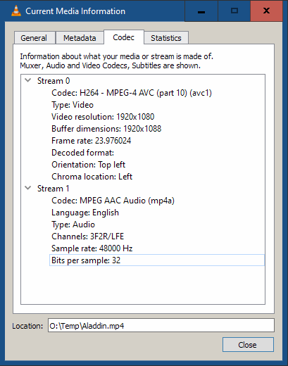

Up until recently, I was able to play MP4's with AAC audio tracks without issues. Now, these same MP4's play the video fine, but NO AAC audio. Note that I can play these same MP4's without issue with VLC. I'm fairly certain that it's not my Denon (AVR-X1500H) receiver as I have a few AAC audio only files that do play. As it is, just about all these files are DL's are from YouTube, including my own UL's/DL's), most of the content being tutorials, ham radio related, old PD classic movies, etc. Again, all these files DID recently work, then all of a sudden, ALL stopped playing back AAC audio. All my other files are Dolby Digital of various kinds, and all work fine.
Is there some transcoding option (which I don't see) that will take the AAC soundtrack and re-encode it in AC3 (Dolby Digital), or just about any other audio format, other than AAC?
One thing is, I've re/installed various versions of UMS, in addition to the legacy PS3 Media Server, and Mezzmo, again, all these used to work, but NONE are now on AAC soundtracks. I also loaded the K-Lite Codec Pack, just for S&G's, but still no joy. As I can't quantify when this started, I don't know if it was after the latest Win10-64 update (20H2), as I usually don't watch these MP4's that often.
I use the Western Digital WD-TV player to watch all my Media Server content.
The attached logs show that I did two short streams, first with "Aladdin.mp4" (with its 5.1 AAC soundtrack), and a re-rendered version, "Aladdin AC3.mp4" (using Vidcoder) of the original AAC file, re-encoded in AC3. "Aladdin.mp4" file plays video/audio fine in VLC. In addition, below is a snapshot of VLC's reporting of its codec data.
I did look at the log UMS log files, and did not see any apparent indication of a streaming error, but I may not be looking in the right places.
To reiterate, these MP4 AAC video files did play normally in the past with UMS/PS3-MP/Mezzmo, but not now. Any help would be very gratefully appreciated.
Thanks, Bill

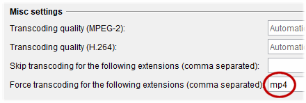

You should be able to confirm this by going to the #--Transcode--# folder and choosing "no transcoding" to play those files unchanged. You can also try one of the other options to force UMS to transcode then and see if that works. Another thing you can try is playing directly from a USB drive if that is possible.
Well, forcing MP4's to be transcoded seems to have resolved (but not fixed) the problem, and now stream as Dolby Digital, not AAC.
Unfortunately, ALL MP4's are now transcoded, whether or not they have AAC or DD soundtracks. It's difficult to know if or how this impacts UMS performance, but so far, it appears to work fine. I should also note that I did the same change with PMS, and that now also works.

Also don't forget to remove the forced transcoding for mp4 otherwise this will be ignored. Transcoding should be avoided whenever possible.
