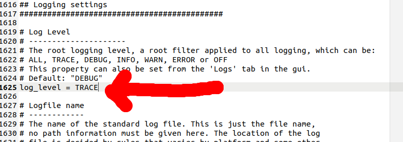

As you can see from the attached screenshot, UMS.conf already has Log_Level = TRACE:
Screenshot from 2022-03-06 19-09-38.png (46.95 KiB) Viewed 14927 times
The above is a screenshot of /home/main19/Applications/UniversalMediaServer/UMS/UMS.conf

Re: Unable to open UMS panel
I missed that you said you were using Linux :oops:
The UMS.conf file in /home/main19/.config/UMS is the one used for the settings so that is the one you need to edit to add Log_Level = TRACE on to the end.
The one in the UMS directory is used on first run to set up the conf for that user on the computer and has each setting documented while the other one is stripped down to bare minimum to run in each users config.
I have very little experience with Linux but hopefully I can spot something in the trace logs that can narrow down your problem.
