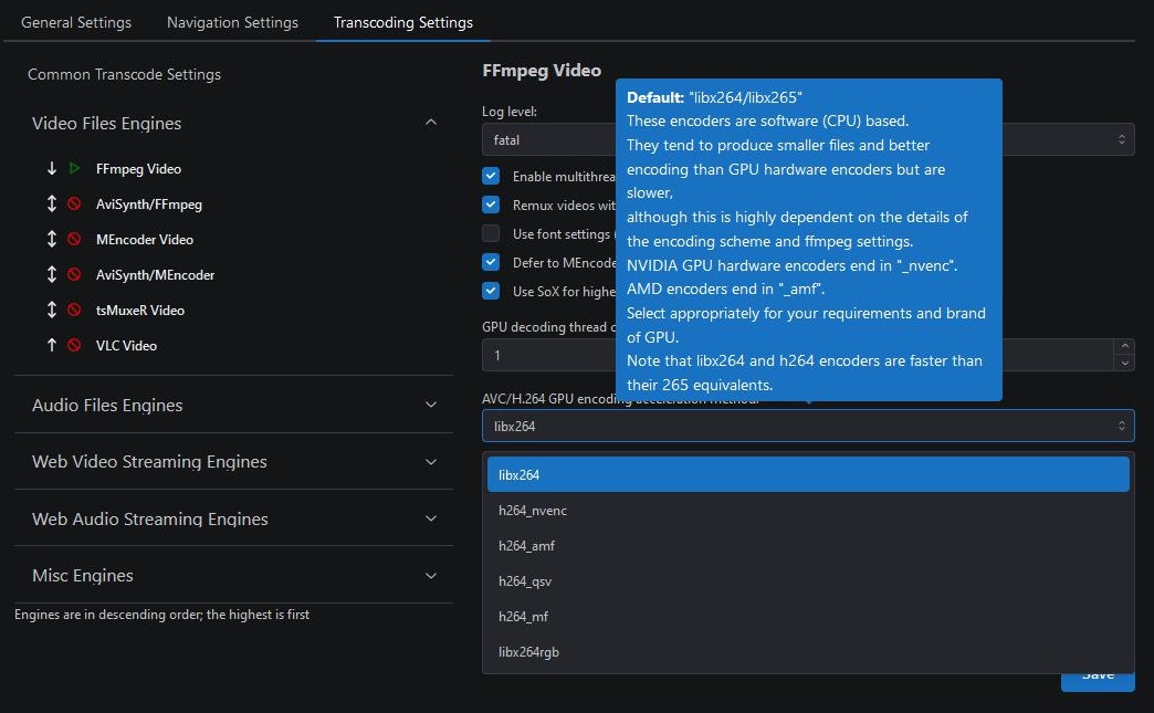

As far as I know the version used by UMS already has support for hardware encoding using the GPU so you should not need to build it yourself unless there is something specific you need. I would suggest using the version that is installed with UMS.
