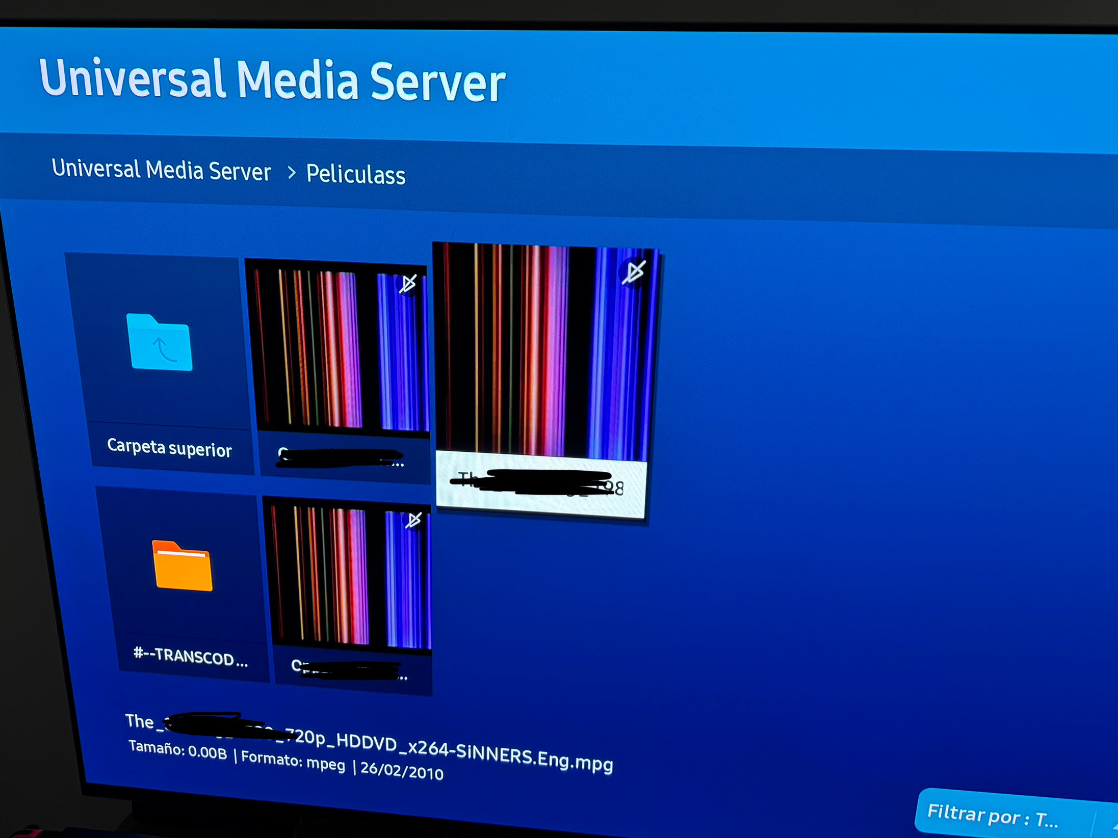

Hello guys,
I am having a hard time trying to play files on my server.
A few weeks ago I had no problem playing avi, mkv or mpg files directly to my samsung tv, but now i am experiencng 2 types of bugs.
1- Sometimes all my files aren't even playable (there is a crossed play icon on the thumbnail and the file size is 0.00b)
2- Now i am able to play a mpg file but i think it's doing real time rendering (i can't fast forward the file and there's some quality loss, like streaming a YT video with slow internet)
I have attached the log file.
Can anyone help me ? I have no idea what i am doing wrong.

There is not a conf file for that series TV so UMS is falling back on an old one to give some compatibility but is causing videos that the TV supports to be transcoded.
I altered a conf from a 2021 TV that should have similar support for formats so will work better but this will not be 100% right.
Just copy to "C:\Program Files (x86)\Universal Media Server\renderers" and restart UMS

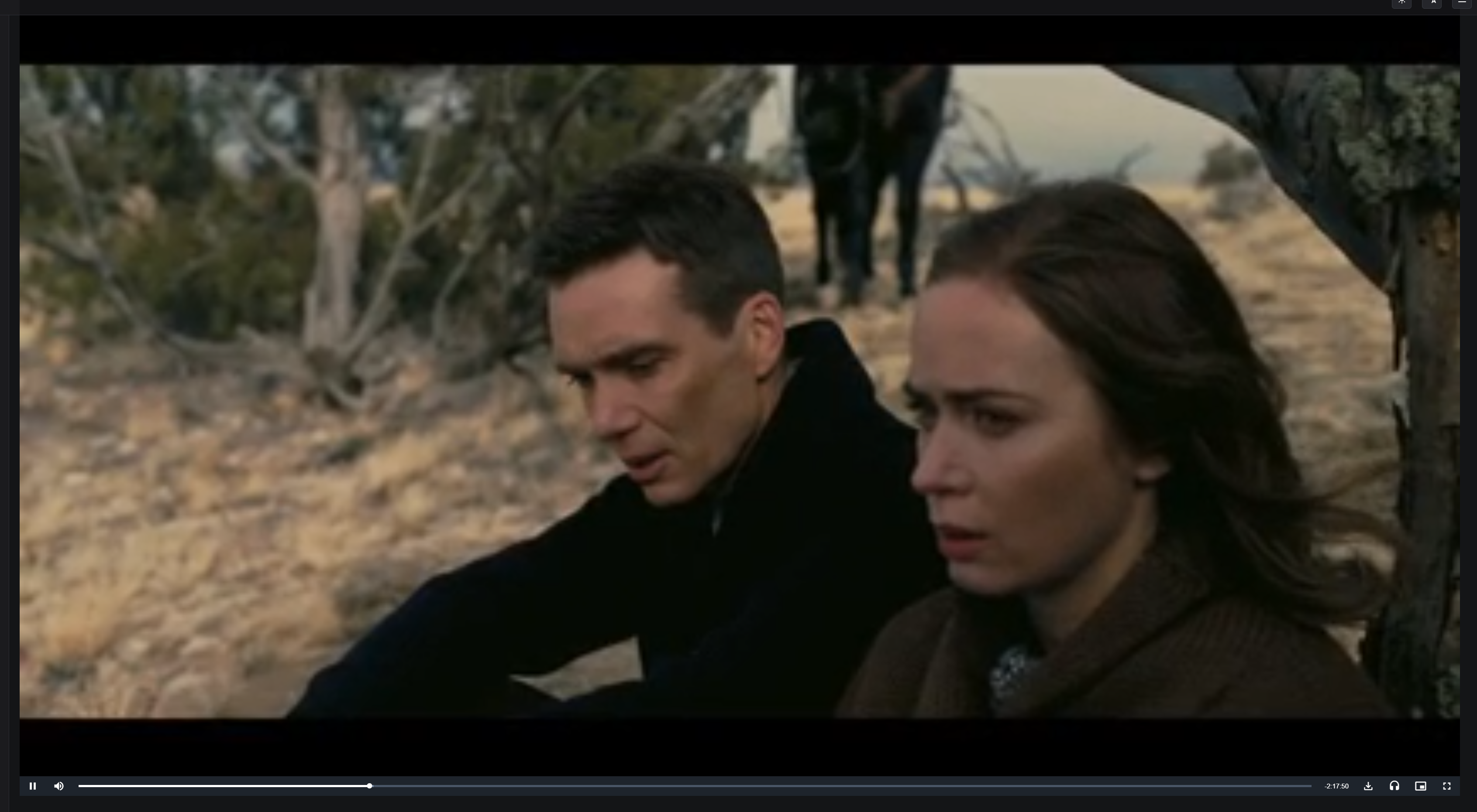

Thanks for the reply. I am currently forcing this config file as default renderer and the file is still showing as 0.00b and is being transcoded. Do you need a new log file ? I don't know why this is happening, the file is a mkv file and i had no problem playing those in the past.
As you can see this is terrible, i am testing it on the webplayer and i the quality loss due to transcoding is huge even on the webplayer itself.

Don't force UMS to use this, let it choose itself and if it picks the wrong one then do logs so I can see why.
It could also be there is a format that your TV can't play and UMS is still transcoding, something like DTS as many TVs removed support for this to save on licencing fees.
I will need to see what the decision making process is in the logs to confirm.
To confirm the video will play without transcoding then try playing from the #--TRANSCODE--# folder and choose "No transcoding"
If this plays without problem then the conf can be tweaked.
