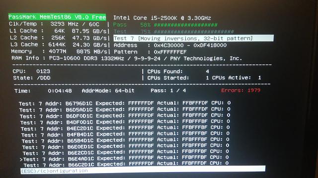

Looks like i have found the faulty stick
The first one ran 20 mins without an error so cancelled and did the other one, errors came up straight away

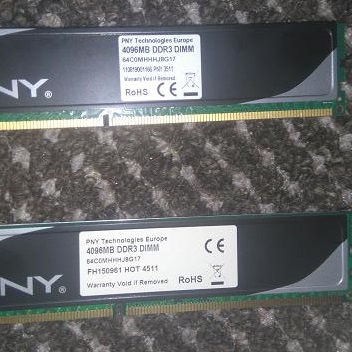

Strange thing is the 2 sticks are supposed to be the same, have the same part number and look the same, but first one is reported as SpecTek when it should be PNY. and it is the PNY one that has failed :?

It seems like the usual marketing mumbo-jumbo (branding): https://forums.anandtech.com/threads/is ... k.1067427/
Old thread, but some things never change ;)
Re: My computer problems
ah that makes sense. I couldn't remember if they were supplied with the motherboard and CPU when I bought them as a kit or if the memory was separate. I might have only bought 1 then then added the 2nd at a later date.

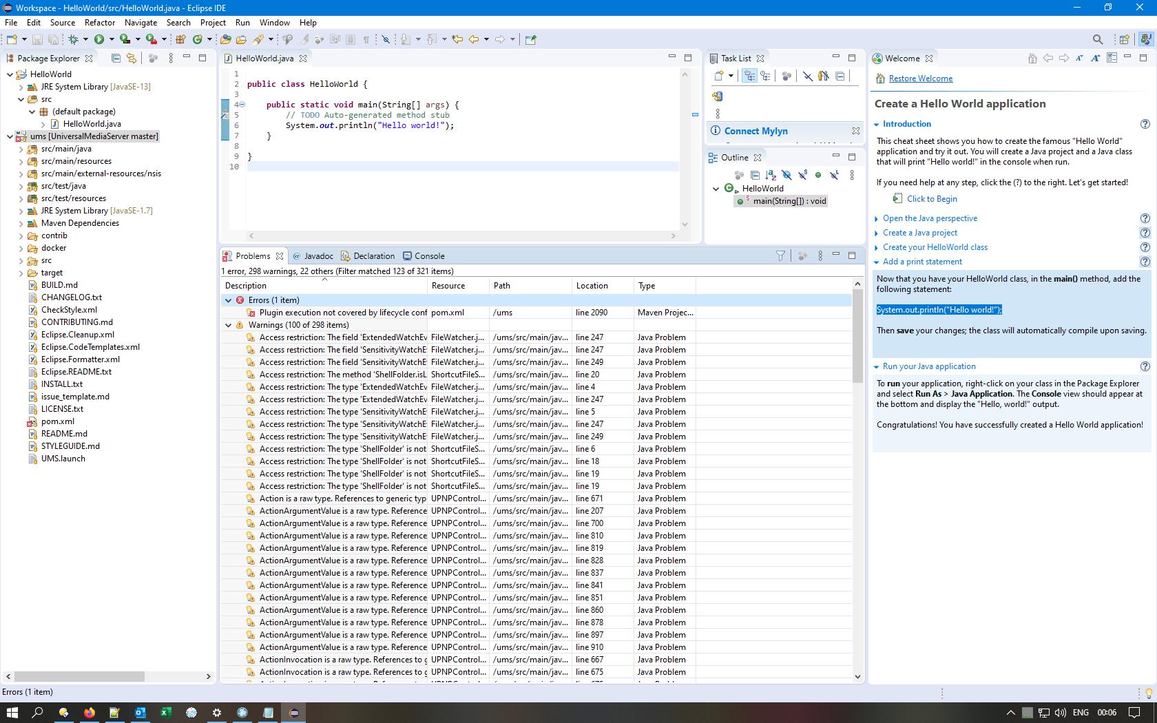

Might need some help with that
got Java JDK, Git, and Maven installed following the build instructions on GitHub
Installed eclipse and trying to import the UMS source as a project
The Eclipse.readme says the to name the project "UniversalMediaServer" but it imports as "UMS" and don't know how to change it

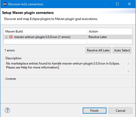

Also getting errors importing

If i just click there are also nearly 300 warnings

that's a far as I'm getting so far

Don't bother with the project name, it doesn't matter. The whole reason it is specified is so that you run UMS using "UMS.launch" in the repository root. Personally I don't use that anyway, because I think it's much more convenient to create one or more "Debug Configurations".
Eclipse has both "Debug Configurations" and "Run Configurations", I only use "Debug Configurations" because I have never seen the point of the other. Both are ways to run the application (UMS) from within Eclipse, but when you use "debug" instead of "run" you also have the debugger available should you wish to use it (you can learn about that later). I guess using "run" is faster, but that's not really my main goal when running from Eclipse :)
Anyway, if you create a "Debug Configuration" (once the import is done), the name doesn't matter.
The antrun error is new to me, it might be they have upgraded the antrun plugin lately and that it's somehow incompatible with "m2e". "m2e" is short for "Maven to Eclipse", and is a "bridge" between the two systems that lets Eclipse "understand" Maven projects. Unfortunately, m2e needs more information that what it can infer for some Maven plugins, which is when you get this kind of error. The solution is usually to add some definition file (XML file with plugin definitions) somewhere, but it's not always terribly easy to figure out how/where. This shouldn't be something you would need to handle, so it might be that they have missed something when upgrading the plugin.

Something corresponding should be in UMS' "pom.xml", and it should make sure that you didn't get this error. I can't quite answer what the exact resolution for this is without looking deeper into it. Valib is using Eclipse, so I would think that he had already faced this issue.
When it comes to the warnings, get ready to get used to them :) When you get experienced, you might find warnings that you find interesting and want to look further into, but for now you must just ignore them. Eclipse warns for many things, not all are that important. You can configure what warnings Eclipse should show and not, but that said, UMS is full of "issues" that trigger warnings, and some of them are absolutely relevant. I'm used to seeing 6-700 warnings, but you learn to ignore them :)
The errors can't be ignored though, because they have consequences. Until the antrun issue is resolved, you will have an error there. Likewise, it's too early to get into how to make a "Debug Configuration", the error must be dealt with first.
