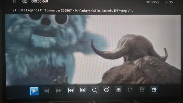

I don't think most Samsungs use seek by time as most of the comments about unable to FF have been on Samsung TVs.
Did a quick test on my F series using exclusive but made no difference. Although it did show a total length, it was not correct. and FF RWD are greyed out
