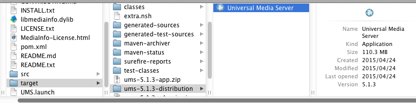

Optimus_prime wrote:NB is only so you can build your own versions which java 6 should be fine
I am Java 8 so as to also track down the access permission and port issues.
Optimus_prime wrote:are you launching UMS form the .dmg it makes for you?
No - I launched directly from:
Screen Shot 2015-04-26 at 9.29.45 AM.png (45.41 KiB) Viewed 13941 times
I did not see a way in NB to build the package.
I tried: "mvn package -P osx" but no "*.dmg" anywhere in my user tree.
Also I loaded the NB-Java8 package directly from Oracle.

mvn com.savage7.maven.plugins:maven-external-dependency-plugin:install-external
Yes - I believe it solved the early build issues.
Is it needed after every NB-Java install or just after getting the UMS tree?
Lastly:
- if I save aside my modified files, do I just copy them back after a clean source download?
- does NB automagically sync from the backing tree in realtime?
- how do you merge in changes from the backing tree?
- do you build from inside NB or CLI (command prompt)?
