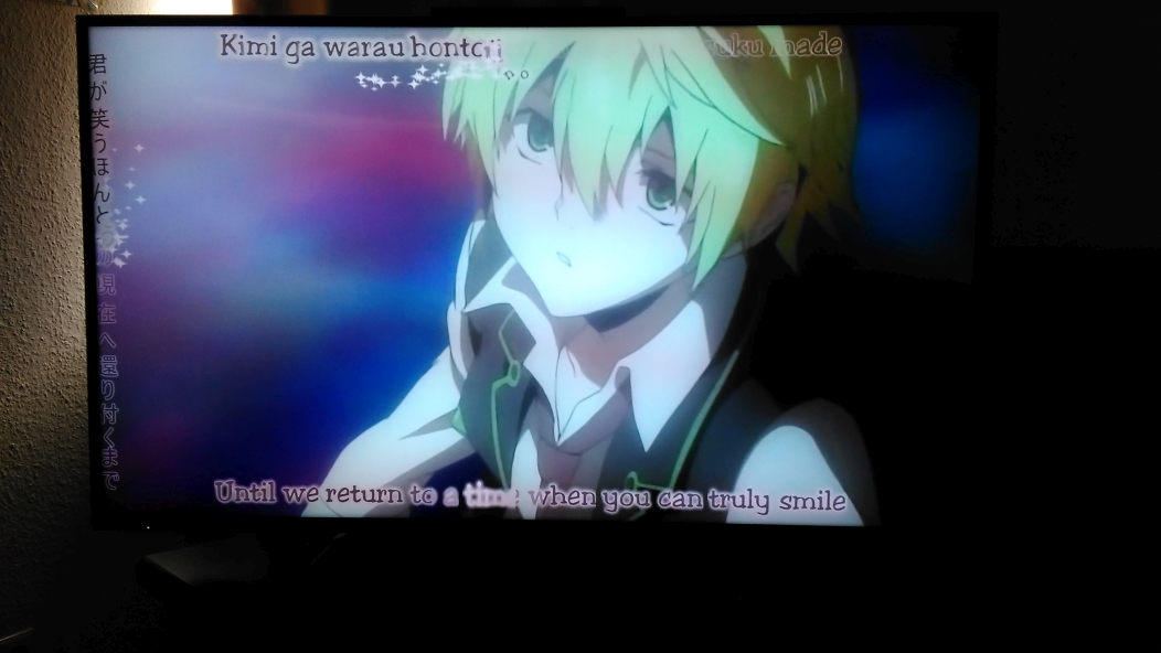

I tested one of the files with the "No transcoding" option and it plays just fine. Subtitles are styled for the intro and I have no issues going forwards or backwards.
Skipping to any point in the video is actually INSTANT when I use "No transcoding" which is very, very nice. I didn't think it was possible haha.

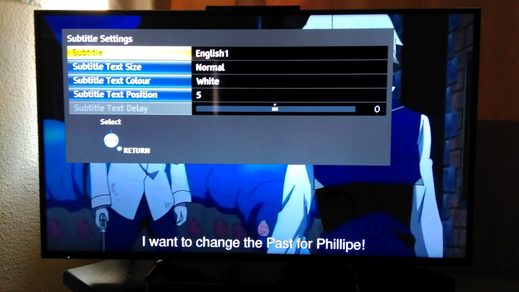

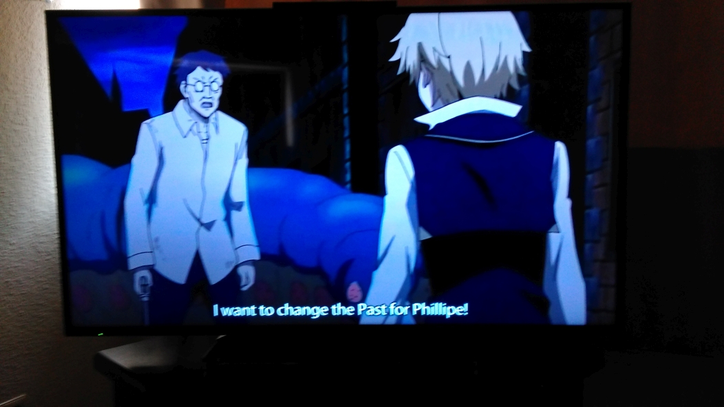

I also checked the options for subtitles on my TV but these were actually set to "off". I can choose Russian2 and English1, however they are very simple compared to before and on pc.
I've added pictures of the subtitles (intro, before and after). I noticed that this series has mostly AAC and some MP3 audio, but the bulk of my anime has FLAC which the TV won't support.
Also, I have no idea how to not make the attachments load in my post... It's kind of annoying for other users I think.
Anyway, what exactly does this mean for me?

Thanks for confirming that, Codyksp. The next release will have better support for your TV. In the meantime you can choose the FFmpeg option from the #-TRANSCODE-# menu if the file has FLAC audioCodyksp wrote:I tested one of the files with the "No transcoding" option and it plays just fine. Subtitles are styled for the intro and I have no issues going forwards or backwards.
