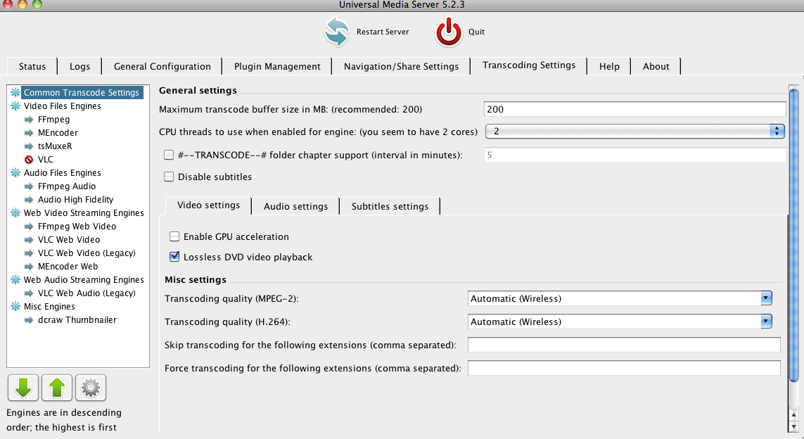

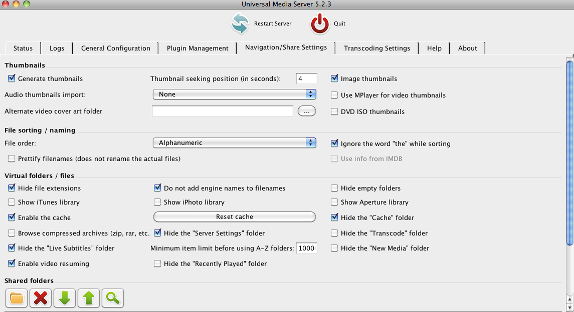

Does the file play with the [No Encoding] option from the #--transcode--# folder?
I can't find an option to enter NO ENCODING as suggested - check out attached screen grabs. Am I looking in the right place?
Cheers
miklos

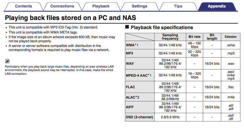

I can't locate any option on the Marantz to select NO ENCODING as suggested.
Attached is the supported files page from the Marantz handbook - showing aiff/aif as supported (but I already know this since they playback from i-Pod/USB sticks direct into the Marantz). It just seems that AIFF for some reason are not being allowed (FILE FORMAT ERROR) - mp3, WAV and FLAC all come through without any additional settings.......:-(
Cheers
miklos

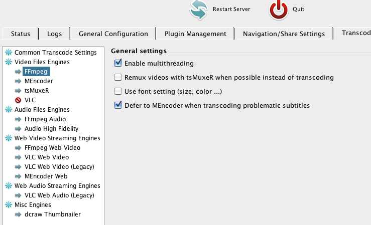

I am not 100% sure what I am doing with these FFMEG settings BUT I have downloaded both codes from the links but am unsure how I link these through to UMS.
Don't forget to rename it as the one used by UMS.
Set FFMpeg as your first choice video engine and send us a new log for see if it'll now work as expected.
How do I do this on UMS? Or is it automatic?
Attached is the UMS Window that I suppose I use to configure this - but can't seem how to achieve it - set FFMEG as first choice video engine ....
Sorry to be a pain.
Miklos

OK, it's fine, FFMpeg is already your first engine choice, so you don't need to do anything.
