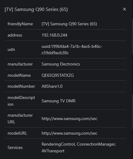

How do I see if it is using that conf?
In ums i see only this by clicking on info at Q90:

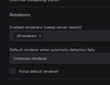

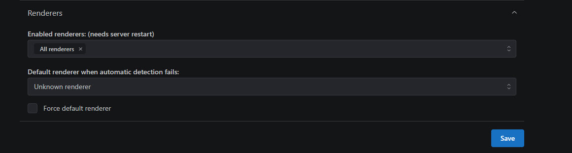

Try setting "Enabled renderers:" to All renderers (or click the x buttons to remove everything so it is set at default)

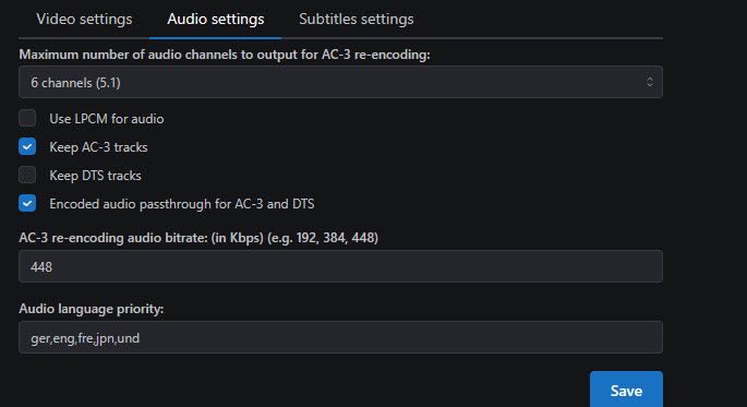

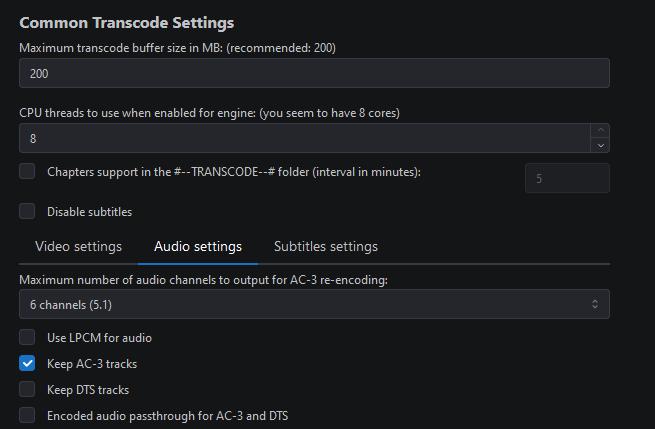

One of the transcoding settings may be causing the problems too.
There is an option to keep DTS tracks when transcoding and you have that enabled, try it with this turned off along with the pass-through option

Thanks for your response. I have enabled all renderers
and set passthrough in the transcode settings.

For the passthough option I meant have it turned off too, probably won't make a difference just wanted to make sure there is nothing DTS related turned on.
