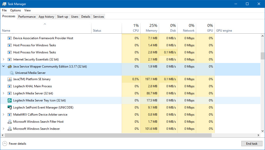

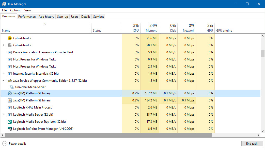

After reinstalling I use the 'Start with Windows' checkbox. So when opening I do so from the task bar.
After a reboot I checked windows processes and only one instance is running. I then tried opening a second instance manually. You can see the difference in the attached files.
Processes 1.jpg (185.92 KiB) Viewed 12976 times
So I have no doubt that after reboot I only ever have one instance running.
I also attach the debug following a reboot.
Processes 2.jpg (178.43 KiB) Viewed 12976 times
