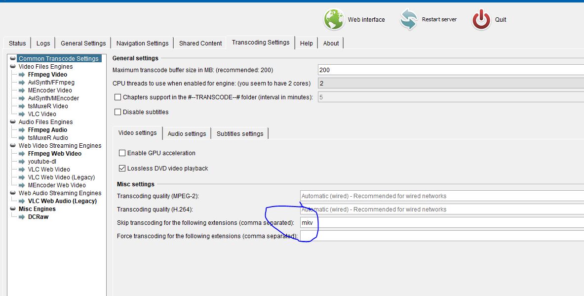

That was an interesting testFirst thing to try is to see if your TV can actually play it without transcoding. Go to the #--TRANSCODE--# folder and chose "No Transcoding" and UMS will stream the file unchanged, and if that works then the conf can be tweaked to say those are supported. might even have to create a better conf for that series.
I don't understand your suggestion to go to the #--TRANSCODE--# folder
I went to the Transcode tab, and put "mkv" in the 'Don't transcode box" and it seems to have worked
Are the options in 10.8.0 different?
- Capture.JPG (108.54 KiB) Viewed 53199 times

OK
I checked the "Show TRANSCODE Folder" box in UMS and the TRANSCODE folder showed on the TV (I didn't know THAT was I was supposed to find it)
and I removed the 'mkv' from the "Skip Transcoding" box
