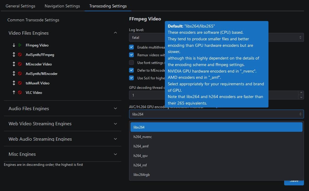

I'm using UMS on arch. Not sure why, but it seems like ffmpeg is totally busted on my setup. Not sure what to try.
I was trying to set up hardware acceleration. I compiled ffmpeg from source with git clone, make & then sudo make install - now everything's busted. I tried sudo make uninstall, no luck.

I'm not that familiar with either building FFmpeg or with linux so I'm not 100% sure what the problem is but it may be that UMS is using a version of FFmpeg that is already on your system and not the version you are compiling. If this is the case then you can set which one to use by editing UMS.conf to point to the right one.

As far as I know the version used by UMS already has support for hardware encoding using the GPU so you should not need to build it yourself unless there is something specific you need. I would suggest using the version that is installed with UMS.
