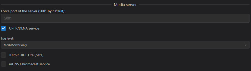

I am not sure if this does that but try changing the log level to "FULL" for the Media server in general settings and Create new logs.
