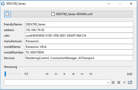

I'm new at UMS, I used XBMC / Kodi for many years. Yesterday I bought my Panasonic Viera TX-50DXW784.
The Panasonic Viera renderer is used:
07:43:10 INFO Reloading renderer configuration: renderers\Panasonic-Viera.conf
Everything with UMS works fine, with the ecxeption of watching 4K movies (rar packed mkv's) in 4K - they are rendered to HD. How can I avoid that?

- Unbenannt2.PNG (13.73 KiB) Viewed 5971 times

From inside your DefaultRenderer.conf, file you could read the following:
That's said, using the default Viera renderer as you do, is not the best way for you to get the most of your TV possibilities. At least you should select/force an other renderer (like Panasonic CX700) with more similar specifications as your, IMO.
Other informations that you could find useful:
https://github.com/UniversalMediaServer ... figuration
https://github.com/UniversalMediaServer ... derer.conf
So, just add these 2 lines in your renderer configuration file:# The maximum width and height supported by the renderer. 0 means unlimited.
# Both must be 0, or both must be higher than 0.
# Defaults: 1920 and 1080
MaxVideoWidth =
MaxVideoHeight =
MaxVideoWidth = 3840
MaxVideoHeight = 2160Other informations that you could find useful:
