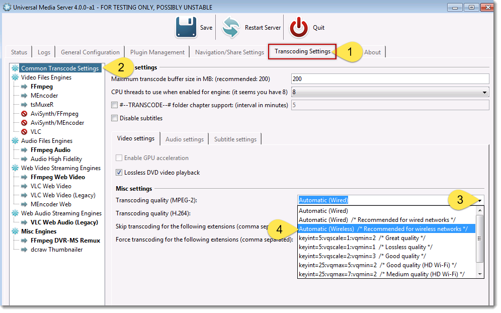

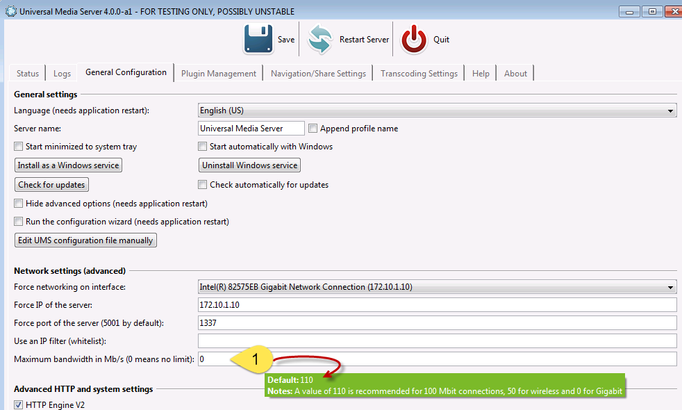

your 2 month trial should have no affect to your internal lan speed... thats only a provisioned speed from the ISP (router to internet) Everythign behind the router will be @wire/wireless speeds... (100/1000 wired or g/n/ac speeds for wireless)ays wrote:I am on a 2 month trial at the moment, fixed wireless (about 10K from the tower) 12 Mps. It finishes in a few days time and I intend to go down to 5Mps.
so to me it sounds like you can pull Youtube just fine (so its not a DNS issue) but when it comes down to trying to access your UMS from your tv its not so good (thats an internal lan setting).
Now after looking over your issues it might be a renderer.conf file issue.. possibly the viso one..)
the best way for us to troubleshoot at this point would be for you to start UMS in TRACE. then recreate the issue, capture the logs using ums buttons. then upload them here.
my guess is that its because its wireless and your UMS settings is not set to wireless.

Possibly... have you edited these two spots?ays wrote:Hi DeFlanko I have already sent in the log files. I can do it again if you need them but is the procedure you describe any different to what I have done already?
Is there a simple way to check UMS to make sure it is set to wireless?
