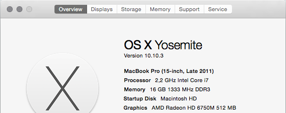

I added my mac specs as well if that's any help
