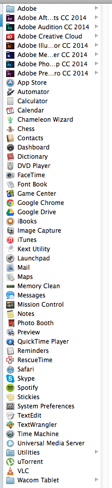

Re: UMS won't start on Mavericks
I'm still facing the issue
Not sure how to find out which programs are Java based.
Would attaching a list of all of my installed Applications potentially help?

Sure, I can find out which use certain libraries that UMS uses that may cause conflicts. I'd like to help in any way i can
Thanks so much for the support! Attached is my Applications list. If there's anything else I can post in order to pinpoint the cause of all this, just let me know.
