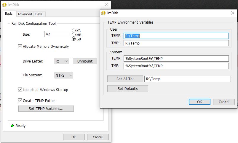

Re: UMS won't launch
As I mentioned, the RAMdrive (R:\Temp) IS my Windows Temp location (as per the below image). Also remember that if Java was failing, I wouldn't be able to use it in my browsers; and more importantly that UMS 5.2x is working fine (tested on both machines), while 5.3+ failing. So putting the blame on Java simple isn't accurate, as our troubleshooting has determined that it's the UMS code update between 5.2 and 5.3 that is causing the grief. That said, it could very well be how UMS tells Java to interact - I don't know... But it's something in the UMS code change that has disabled the ability for it to work on our extremely specific/unique configuration (even though it's a freakin' awesome setup that keeps the system moving incredibly fast, with no space or wear issues on C:\ - I don't know why everyone wouldn't do thisNadahar wrote:What the above shows is that everything is fine with T: - the permissions check is ok and it moves on, but when it comes to R: it fails again. I'm pretty sure there must be something strange going on with the file system on the RAM drive, or simply that Java can't interpret it.
So with 5.2 working, then we just won't update in the foreseeable future... But with v6 on the horizon, I'm hoping this rogue code change can be brought under control for our configuration, and I'm more than willing to help test things, as I've been a faithful user of PS3MS for a bloody long time and have no issue giving back!
- IMd.jpg (63.09 KiB) Viewed 12011 times
