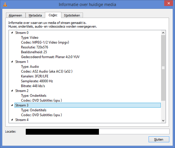

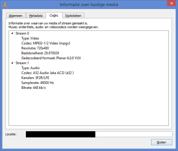

Some of my VOB files have stuttering (drops) in the audio, and some have not. I've googled quite a while, but did not find an answer, so maybe there's someone who could help me. I've recently upgrade from PS3MS to the latest UMS, the PS3MS had the same problems.
VOB info details from a file that gives problem and VOB info details from a file that plays well are attached. Has it something to do with the fps?

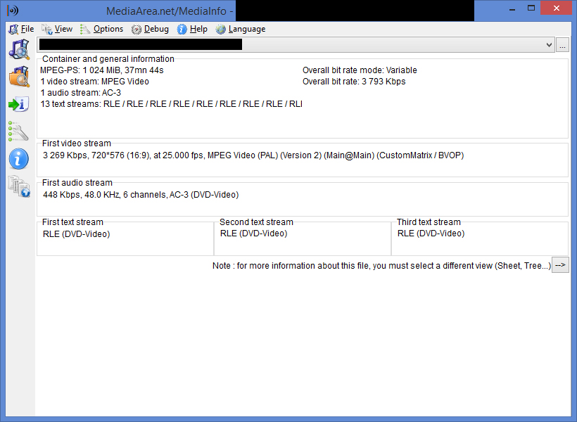

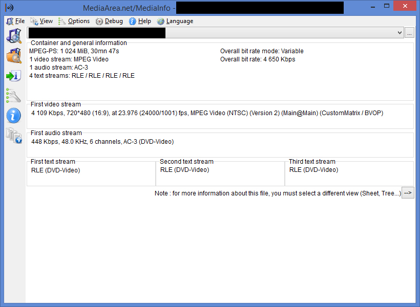

Hereby the info from MediaInfo

- AudioProblemVOBInfo.jpg (235.18 KiB) Viewed 10495 times
- AudioGoodVOBInfo.jpg (236.36 KiB) Viewed 10495 times

In text, first the info of the problem vob:
General
Complete name : F:\VIDEO_TS\VTS_01_1.VOB
Format : MPEG-PS
File size : 1 024 MiB
Duration : 30mn 47s
Overall bit rate mode : Variable
Overall bit rate : 4 650 Kbps
Video
Format : MPEG Video
Format version : Version 2
Format profile : Main@Main
Format settings, BVOP : Yes
Format settings, Matrix : Custom
Format settings, GOP : Variable
Duration : 30mn 47s
Bit rate mode : Variable
Bit rate : 4 109 Kbps
Maximum bit rate : 8 166 Kbps
Width : 720 pixels
Height : 480 pixels
Display aspect ratio : 16:9
Frame rate : 23.976 (24000/1001) fps
Standard : NTSC
Color space : YUV
Chroma subsampling : 4:2:0
Bit depth : 8 bits
Scan type : Progressive
Scan order : 2:3 Pulldown
Compression mode : Lossy
Bits/(Pixel*Frame) : 0.496
Time code of first frame : 00:00:00:00
Time code source : Group of pictures header
GOP, Open/Closed : Open
GOP, Open/Closed of first frame : Closed
Stream size : 905 MiB (88%)
Color primaries : BT.601 NTSC
Transfer characteristics : BT.601
Matrix coefficients : BT.601
Audio
ID : 189 (0xBD)-128 (0x80)
Format : AC-3
Format/Info : Audio Coding 3
Mode extension : CM (complete main)
Format settings, Endianness : Big
Muxing mode : DVD-Video
Duration : 30mn 46s
Bit rate mode : Constant
Bit rate : 448 Kbps
Channel(s) : 6 channels
Channel positions : Front: L C R, Side: L R, LFE
Sampling rate : 48.0 KHz
Frame rate : 31.250 fps (1536 spf)
Stream size : 98.6 MiB (10%)
Text #1
ID : 189 (0xBD)-32 (0x20)
Format : RLE
Format/Info : Run-length encoding
Text #2
ID : 189 (0xBD)-33 (0x21)
Format : RLE
Text #3
ID : 189 (0xBD)-34 (0x22)
Format : RLE
Text #4
ID : 189 (0xBD)-35 (0x23)
Format : RLE
Menu
And of the good VOB:
General
Complete name : G:\VIDEO_TS\VTS_01_1.VOB
Format : MPEG-PS
Duration : 37mn 44s
Overall bit rate : 3 793 Kbps
Video
Format : MPEG Video
Duration : 37mn 44s
Bit rate : 3 269 Kbps
Width : 720 pixels
Height : 576 pixels
Frame rate : 25.000 fps
Standard : PAL
Color space : YUV
Bit depth : 8 bits
Bits/(Pixel*Frame) : 0.315
Stream size : 883 MiB (86%)
Audio
Format : AC-3
Duration : 37mn 43s
Bit rate : 448 Kbps
Delay relative to video : 600ms
Stream size : 121 MiB (12%)
Text #1
ID : 189 (0xBD)-41 (0x29)
Format : RLE
Duration : 37mn 41s
Delay relative to video : 3s 280ms
Text #2
ID : 189 (0xBD)-42 (0x2A)
Format : RLE
Duration : 37mn 36s
Delay relative to video : 5s 640ms
Text #3
ID : 189 (0xBD)-43 (0x2B)
Format : RLE
Duration : 37mn 36s
Text #4
ID : 189 (0xBD)-44 (0x2C)
Format : RLE
Duration : 37mn 36s
Text #5
Format : RLE
Text #6
Format : RLE
Text #7
Format : RLE
Text #8
Format : RLE
Text #9
ID : 189 (0xBD)-36 (0x24)
Format : RLE
Text #10
ID : 189 (0xBD)-37 (0x25)
Format : RLE
Text #11
ID : 189 (0xBD)-38 (0x26)
Format : RLE
Text #12
ID : 189 (0xBD)-39 (0x27)
Format : RLE
Text #13
ID : 189 (0xBD)-40 (0x28)
Format : RLE
Menu

The only "obvious" difference I can see is that the trouble file is NTSC while the other is PAL. That means different framerate and resolution. I know virtually nothing about this, so somebody else should try to help, but you could check if the same is true for the other problem VOBs - if they are NTSC.

I've tested 9 vob files, and 3 of them had audio problems. According to MediaInfo those 3 have no standard, like below...
(the 6 vob working are PAL...)
Any Idea's?
Thanks in advance
Any Idea's?
Thanks in advance
