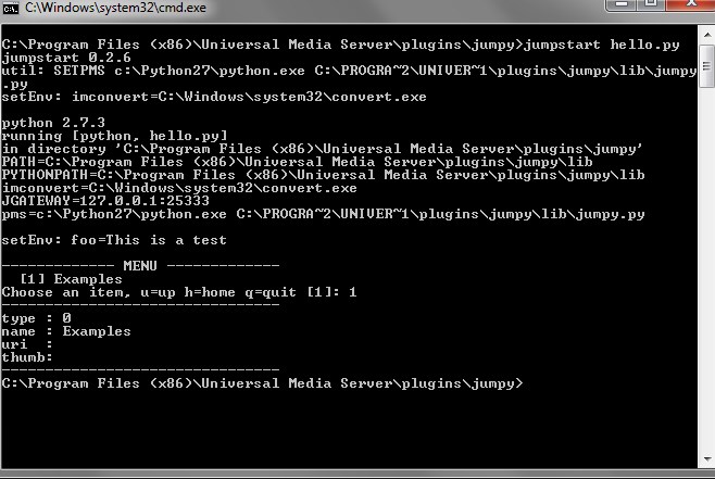

So that was easy to fix. But when I tried jumpstart hello.py I get the following results.
Is that normal?
When I select the 1 I expected the python brunch and then the Hello/Version brunch.
Do I have a wrong expectation or a wrong usage?
Maybe you could give me a sample screenshot from jumpstart hello.py.

Thanks for testing Hans, as you can probably tell it's been a while since I tried running hello.py myself :). No, your expectation is right and the fault is with jumpstart. Here's an updated version with the scripts fixed too:
jumpstart-0.2.7.zip
unzip to plugins/jumpy/
(23.64 KiB) Downloaded 1687 times
