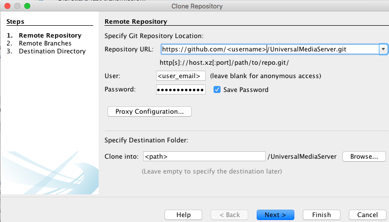

Then you need to check out your fork with git
Here I took the NB way: Menu > Team > Git > Clone… and Step through all three screens.
Screen Shot 2017-01-06 at 12.27.41 PM.png (61.29 KiB) Viewed 46558 times

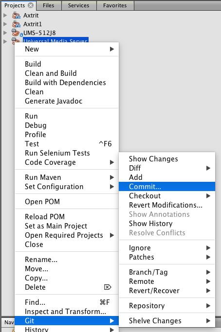

and "commit"
Done.
Screen Shot 2017-01-05 at 7.21.02 PM.png (68.23 KiB) Viewed 46569 times

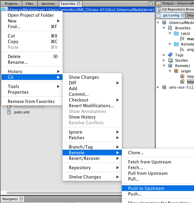

and then use git "push to upstream" to update the fork on GitHub.
Done.
Screen Shot 2017-01-06 at 12.06.29 PM.png (94.57 KiB) Viewed 46559 times
