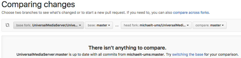

Now stuck on GitHub pull request.
Pictures better/faster than words. Tried different base/head/fork/compare combos - nothing.
This is not intuitive.
What am I doing wrong?

The NB push didn't work/the changes are not pushed to https://github.com/michaelt-ums/UniversalMediaServer

As long as you haven't entered your github credentials anywhere in NB, I can guarantee you that no push has been performed. You don't have write permission to your GitHub fork without them.
Re: Can't see option "Prevent OS from sleeping when streaming"
Found the problem: "Push" sb "Push to Upstream"
