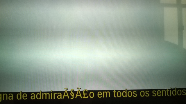

Hello everyone.
I'm having a problem with subtitles.
Searching the forum here, I discovered that adding the line
"RemoveTagsFromSRTSubtitles = false" would solve the character question. Partly to me, yes.
What happens is the following:
Only works perfect if I convert the encoding of the caption to 8859-1, with UTF-8 characters continue.
Not that it's a problem (just convert), but I wish I did not have to.
I set up a specific render for my TV, since none has adapted to it.
I wish they could help me or implement UTF-8 encoding as a choice.
Adding my TV only has in options default subtitles and Korean
He used minidlna and this problem did not occur with subtitles.
Thank you
