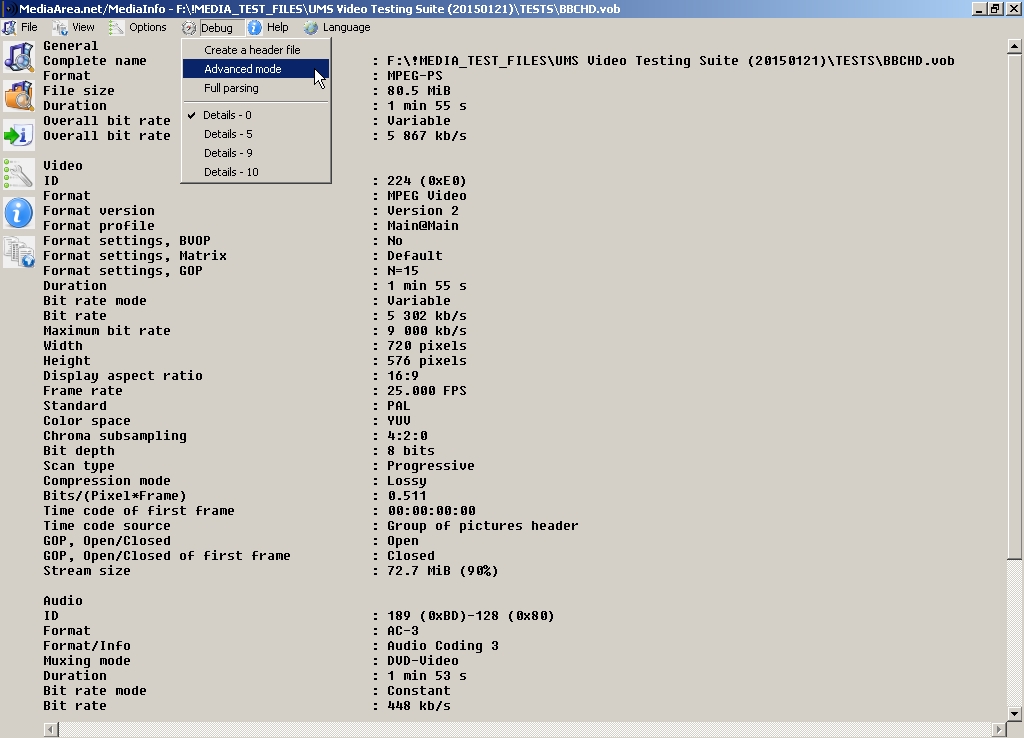

If you still get issue, as you media have a weird timebase that is certainly the root of your issue, could you post the full enhanced MediaInfo log ? Thanks.
Go into the MediaInfo GUI "Debug" tab, and select "Advanced mode". Then copy/paste the result here, or attach the log.

Where do I find the Mediainfo GUI tab? Is that in UMS or Mediainfo or something else? I have Mediainfo installed, but can't find advanced tab anywhere..

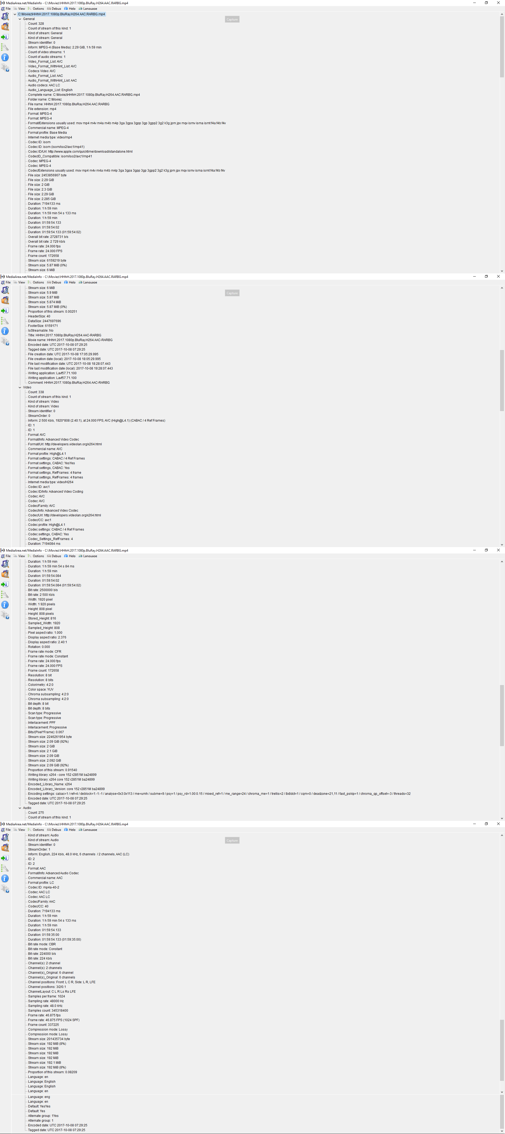

Re: Mediafile/Video skipping when transcoding
If you could post something like that it will be nice

fedeaffedaffe
- Posts: 11
- Joined: Tue Oct 31, 2017 9:40 am
Hope this helps
The .txt file is advanced mode "details -0" and the .png file is with "details -10", for some reason I can seem to display the later in txt mode.
Kind Regards,
Bjarke
Kind Regards,
Bjarke
- mediainfo.png (389.55 KiB) Viewed 18307 times
mediainfo.txt- (12.97 KiB) Downloaded 707 times
