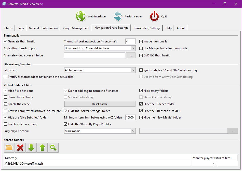

In ums.conf if he has: "folders = \\192.168.1.50\tv" that shows up as "tv" in his UMS menu, when he selects it, it shows the contents of "\\192.168.1.50\tv"
In ums.conf if he has: "folders = \\192.168.1.50\tv\new stuff" that shows up as "new stuff" in his UMS menu, when he selects it, it shows the contents of "\\192.168.1.50\tv"

Nadahar, the problem is very simple:
say in ums -> navigation/share settings, i type the full path of where my files are, like this (look at the bottom of the screenshot)
Why doesn't ums show the content of the last folder in the path , this one is called "stuff_watch" ? The tv or the file explorer or the web interface only shows the folder "TV" where stuff_watch is.
it only show the root of the share. it should show the content of the folder. i think i've been pretty clear.

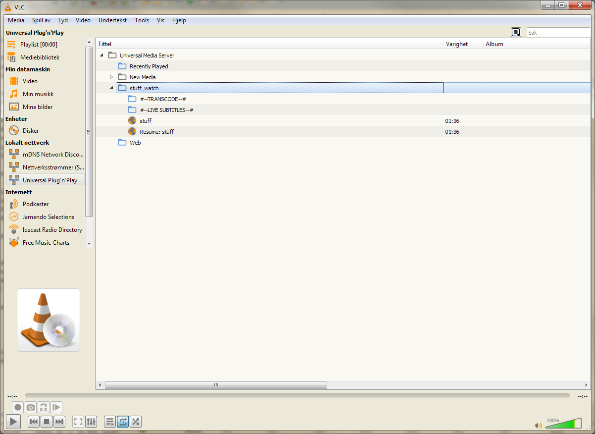

The problem is that when I'm testing this, it doesn't behave the way you describe. I've replicated your setup as exactly as I can, even using IP address for the share instead of computer name, and my result looks like this:
This is exactly what I'd expect, and it's still unclear to me if UMS has a different behaviour for you or if you simply don't like having to click on "stuff_watch" first.

I have tried it with Windows, I'm running it on Windows 7. Windows 10 is nothing but Windows 7 with a uglier UI and a lot more spying on you and trying to annoy you into using Microsoft's services and shop. The internal version numbers are more truthful, Vista is 6.0, Windows 7 is 6.1, Windows 8 is 6.2 Windows 8.1 is 6.3 and Windows 10 was 6.4. They've since let the marketing department mess with the internal versions as well and change it to 10, but it's bullshit. It's very easy to see that they are 99% the same, and that all that's different with 8 and 10 is that microsoft is trying to use their market position on desktop OS'es to get people to use their mobile platform as well. The terrible new interface is simply so that the desktop UI shouldn't be any better than that of the mobile devices. I also have Windows 10 VMs, but there is nothing that is even slightly related to this "issue" that differs between Windows 7 and 10.
I only used VLC to make the tree structure visible on the screenshot. I have used Kodi as well, but the point is that which renderer you use isn't relevant. UMS will generate a "resource tree", and even though the sorting and way it is presented will vary among renderers, the tree it self does not.
Of course we test it on Windows - in fact, testing on the other platforms is what is lacking. All the developers use Windows, so merely suggesting that this is somehow negligence from us is quite arrogant.
It seems to me that the problem isn't a problem at all. This is what I've suspected all along, you simply don't understand the structure. My web interface shows the exact same thing as yours, and so does my VLC, Kodi and any other renderer. What you see isn't the "tv" folder, it's the UMS root folder. Try putting a media file in the "tv" folder and you will see that it doesn't show up.
UMS' root folder will contain all shared folders, web folders, plugins that have their own "folders" and other "special folders". You will find no media in the root folder, it's simply a place where you select what you want to browse. When you select to browse your (single) shared folder, you will see the content of that folder.
It turns out this was only about one "extra" click. If UMS was to show the content of your shared folder as the root, how would you show other shared folders (if defined), Web folders, plugins, new media etc? This is the way it's organized, and there's no bug.
