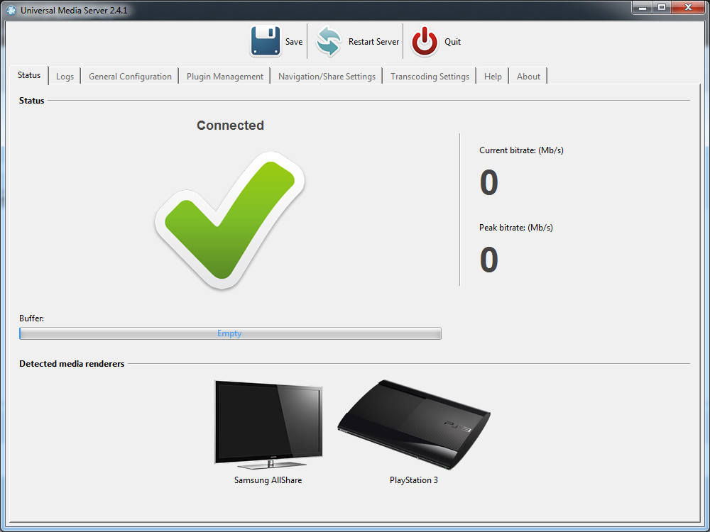

Interesting,
so i've been testing my network config, i'll lay it out to be specific:
1 device on a 192.169.1.something network (Samsung UA55D7000 to be exact)
UMS server on a 192.168.0.something network (Also the paystation in the screenshot is on the 192.168.0.something network)
Both on a 255.255.0.0 subnet
So in theory they should all play nicely. Whilst im not a networking engineer i do know my way around my own network (I run a suite of Cisco gear), for the life of me i can't get UMS or more to the point the device to show UMS.
I've attached a screenshot of the fact that UMS can see the TV and i can ping the shit out of it but i wont display UMS like normal.
Anyone else have any suggestions, i'm open for anything at this point.
- UMS-Subnet trial.jpg (179.63 KiB) Viewed 14017 times
