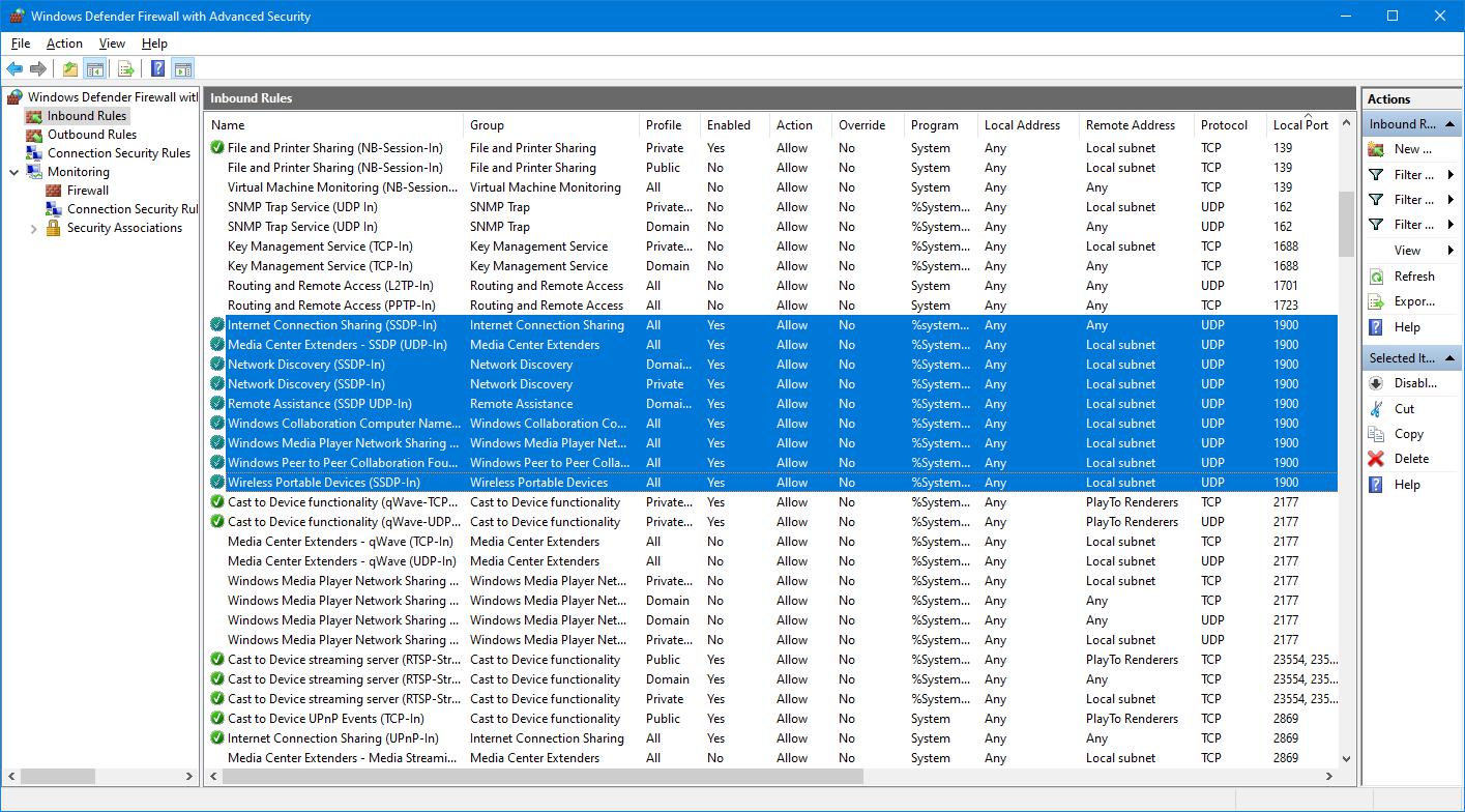

I looked though my windows firewall advanced settings to see all the rules set there. by default for me it is set to block any inbound connection not matched by any rule.
when I looked at what rules were on port 1900 I saw only half were active, and therefore the rest were being blocked, so I enabled them all. These were predefined rules set by windows.

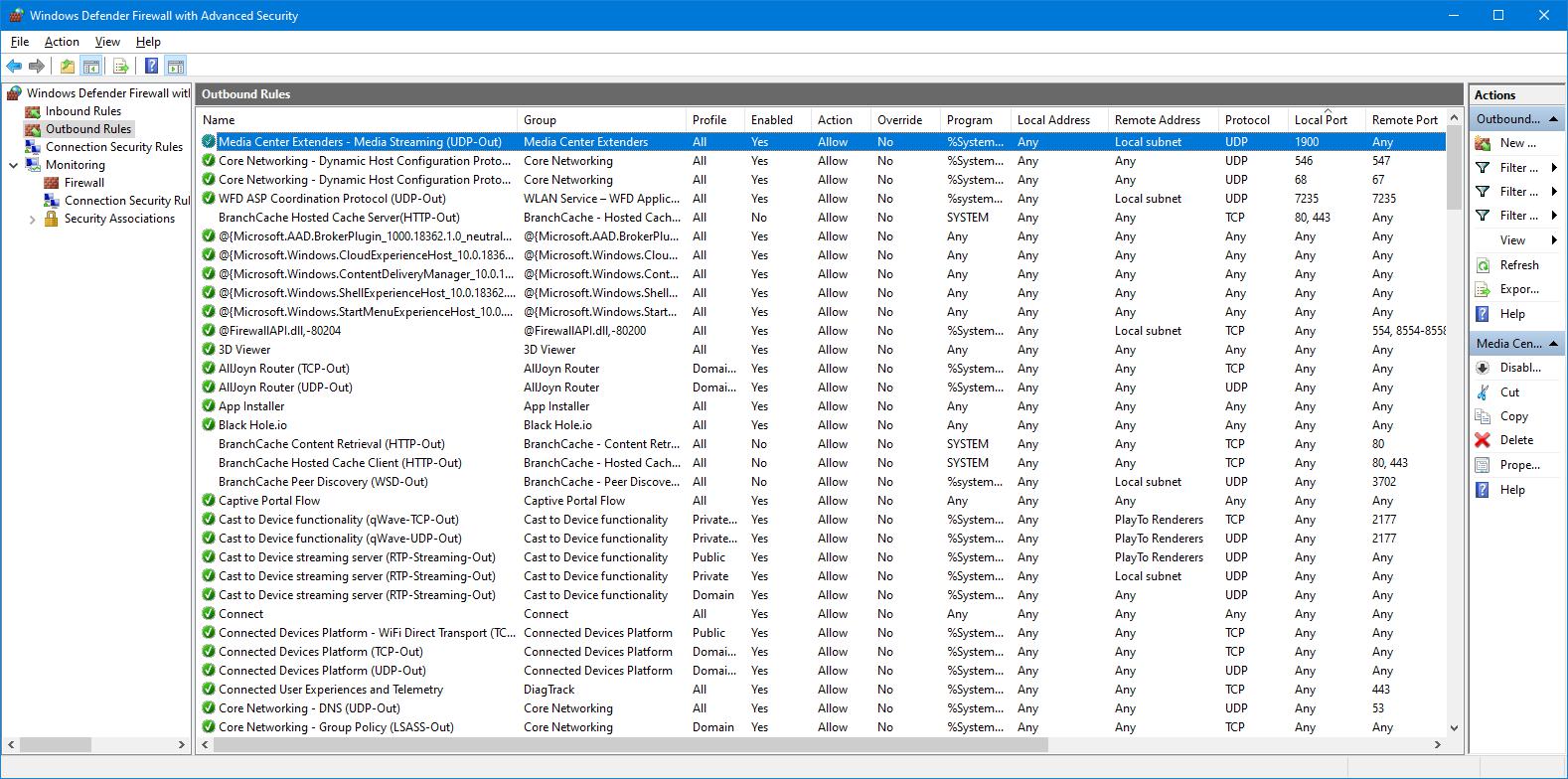

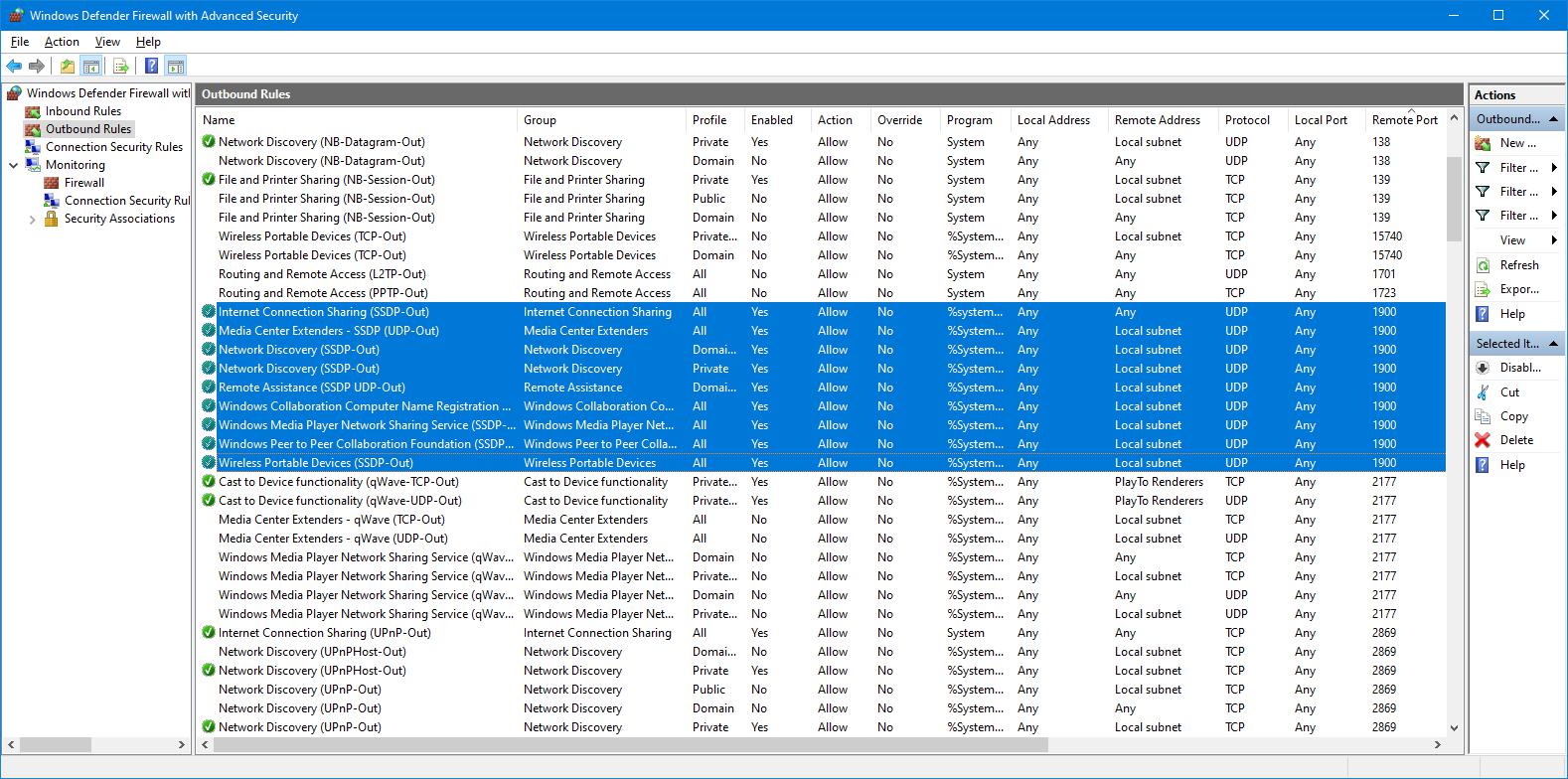

can't remember which ones I turned on but some did mention media streaming. I did the same for any outbound connections too, for both local and remote ports. these are my rules now.
Local Port 1900 Inbound
local port inbound.jpg (240.94 KiB) Viewed 4721 times
Remote Port 1900 Outbound
remote port outbound.jpg (255.87 KiB) Viewed 4721 times
Local Port 1900 Outbound
Local port outbound.jpg (247.51 KiB) Viewed 4721 times
At first I saw no change. I restarted UMS but still nothing , I turned off my TV and I noticed in the logs tab that UMS got a message from the IP my TV is on. turning the TV back on saw a lot of communication between it and UMS and it now shows up as a source.
Its definitely worth checking if you still have any issues connecting to UMS.
