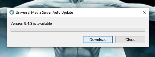

For about the last 4 updates now, the "Auto Updater" has not been working. It will come up and tell me there is a new update.

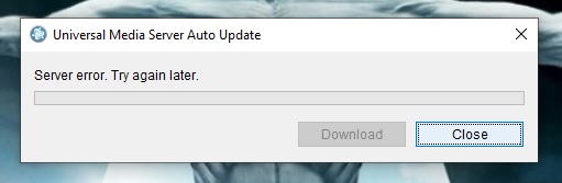

When I click on download, it comes up with "Server error. Try again later".
Server error.jpg (22.32 KiB) Viewed 17452 times
The only way I can get the update is if I go on the UMS website and download it. I'm hoping there a simple solution to this.

I have this same issue. I don't see anything in the logs relating to the auto-updater either so I can't tell why this error message occurs. Hopefully others with the issue decide to post too for more attention.
Edit: Similarly, it was working perfectly fine for me about 2 or 3 months ago maybe, then always gave this error. Nothing changed on my end.

Fixed in the PR https://github.com/UniversalMediaServer ... /pull/2081 which I hope will be included in the next release. Guys thanks for your inputs.
