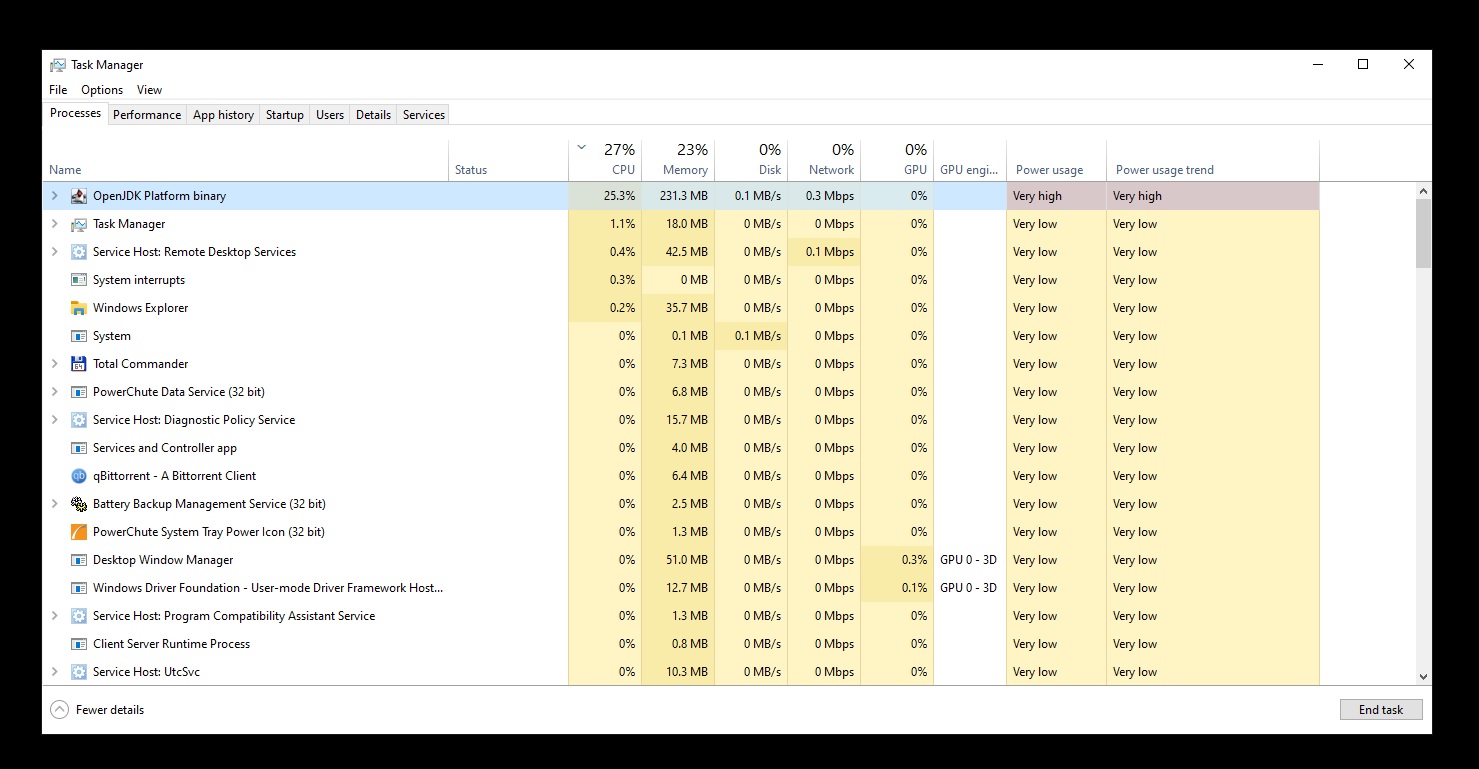

Hi guys. I have a Intel Nuc 4c/4t and after upgrading to v9.7.0/9.7.1 the CPU usage is very high, 25-30% all the time. It seems that OpenJDK is the problem...
