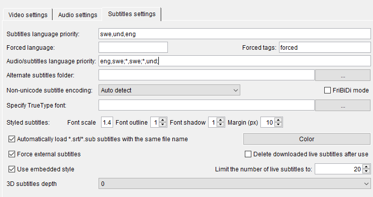

However the other codecs on my TV keeps look broken, only VLC engine that's works okay but it seems to default english subs even tho I have set my native language as first in "Sub priority settings", "Forced Language" and "Audio/sub language priority". The english sub is even 2nd on the list when I open the file normally in VLC on PC, but when I UMS with VLC engine to my TV the english auto loads and my other language is presented on top of that (please note that with ffmpeg, mencoder it displays only my native language sub like I want but it's unwatchable due to the other issue).

Arc ッ wrote: ↑Wed Aug 05, 2020 7:18 am However the other codecs on my TV keeps look broken, only VLC engine that's works okay but it seems to default english subs even tho I have set my native language as first in "Sub priority settings", "Forced Language" and "Audio/sub language priority". The english sub is even 2nd on the list when I open the file normally in VLC on PC, but when I UMS with VLC engine to my TV the english auto loads and my other language is presented on top of that (please note that with ffmpeg, mencoder it displays only my native language sub like I want but it's unwatchable due to the other issue).
I took a screenshot of my settings if it helps, any suggestions would be very appreciated because having double subtitles at once is. 🥴
