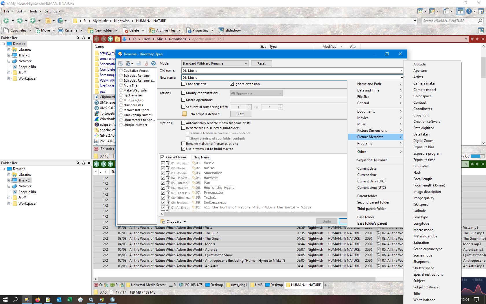

I think I understand what it is you are looking for.
using the example for mp3
if you have your files all mixed together in a directory with unhelpful filenames like
01 Shudde.mp3
01.Music.mp3
02.Noise.mp3
02 Weak Fa.mp3
03.Shoemar.mp3
03 Élan.mp3
04.Harvest.mp3
04 Yours Is .mp3
05. Pan.mp3
05 Our Dec.mp3
06 My Walde.mp3
06. How's th.mp3
07 Endless F.mp3
07. Processi.mp3
08 Edema R.mp3
08. Tribal.mp3
09. Endlesss.mp3
09 Alpenglo.mp3
The Eyes of.mp3
The Greates.mp3
Most players can extract the tags like Track number, Title, Artist, Album, Year and display that instead of the file names
but those that can't you are left with this mess. A work around it to rename the files using the tags to something like
Nightwish - Endless Forms Most Beautiful(2015) - 01 Shudder Before the Beautiful.mp3
Nightwish - Endless Forms Most Beautiful(2015) - 02 Weak Fantasy.mp3
Nightwish - Endless Forms Most Beautiful(2015) - 03 Élan.mp3
Nightwish - Endless Forms Most Beautiful(2015) - 04 Yours Is an Empty Hope.mp3
Nightwish - Endless Forms Most Beautiful(2015) - 05 Our Decades in the Sun.mp3
Nightwish - Endless Forms Most Beautiful(2015) - 06 My Walden.mp3
Nightwish - Endless Forms Most Beautiful(2015) - 07 Endless Forms Most Beautiful.mp3
Nightwish - Endless Forms Most Beautiful(2015) - 08 Edema Ruh.mp3
Nightwish - Endless Forms Most Beautiful(2015) - 09 Alpenglow.mp3
Nightwish - Endless Forms Most Beautiful(2015) - 10 The Eyes of Sharbat Gula.mp3
Nightwish - Endless Forms Most Beautiful(2015) - 11 The Greatest Show on Earth.mp3
Nightwish - HUMAN. II NATURE.(2020) - 01. Music.mp3
Nightwish - HUMAN. II NATURE.(2020) - 02. Noise.mp3
Nightwish - HUMAN. II NATURE.(2020) - 03. Shoemaker.mp3
Nightwish - HUMAN. II NATURE.(2020) - 04. Harvest.mp3
Nightwish - HUMAN. II NATURE.(2020) - 05. Pan.mp3
Nightwish - HUMAN. II NATURE.(2020) - 06. How's the Heart.mp3
Nightwish - HUMAN. II NATURE.(2020) - 07. Procession.mp3
Nightwish - HUMAN. II NATURE.(2020) - 08. Tribal.mp3
Nightwish - HUMAN. II NATURE.(2020) - 09. Endlessness.mp3
as Nadahar says there is no support for similar tags in the protocols and most players for images so the workaround is to do the renaming on the PC side, but I don't think that is something UMS could do and probably difficult to automate something in windows explorer.
My suggestion is try Directory Opus, Something I cannot live without. It can be run to replace explorer and can do many things that are too long to list here.
But one of it's features is very powerful renaming tool which is able to take the metadata to make better meaningful filenames and scripts that can automate repetitive tasks
Clipboard Image (1).jpg (284.53 KiB) Viewed 15905 times
It is not free though but has a 60 day trial, but is worth the price if you want to stick with it. It is one of the few pieces of software that have actually made me want to part with my money :lol:

  • VLC has an IPTC metadata viewer but I have not found the fit space between IPTC model and VLC metadata that can be displayed. I have not found quickly the way (quite sure that it exists) to define what to show. I have not not begin the necessary inquiry, until now.
  • KODI on summaries of images found (search DLNA servers and finds well UMS) has a place to display metadata and more an option to tell to who is viewing the summary if data are "missing - not found" or leave the space empty.
  • There are VLC and KODI a zone at top of images (and video) a space which can show others metadata. No information how to use or if they are usable.
  • It seems that on the old smartHub of my TV and the FreeBox Media data which are displayed (for example IPTC "title" replaced by default by file name).
Then I think that it is the problem of a "user" who want to enhance his display of media to use the capabilities of his renderer (Coherent definition set by user by filling IPTC metadata for his media, configuration of the server and of the renderer)
It is not in my mind that UMS could have to invent any, only, may be, fill some existing in the IPTC model to tell (even not used) this images had been configured by UMS (as defined by conf file).
One question could be : As icons are sent as images to produce the summaries of the images of a folder a part of the iptc of the main image (particularly the title) could be duplicated with (stored into) the generated icon image, is-it something foolish to let the renderer able to produce a list of the images of a folder with the titles displayed next to the reduced images ? This can be an action of an Upnp server if the renderer is able to do this (which can be a standard of the capabilities of renderers which is the lonely solution). Nota : currently KODI displays the list of images on the right and the left contains the icon and under a zone of "content" but I ignore if it exists any correspondence between this content and IPTC metadata or where KODI is seeking this content. So, something is done, or planned in Open world.

More extended comment : Currently I don't know how to get the metadata (some ones may be) displayed or used as filter else than for building libraries (catalogs).
Some renderers does something or seem to have wish todo.
The case of VLC is that there is a panel to display metadata into "tools" on right-click on an image, but the content is empty and there is no documentation at all.
For KODI there is more documentation but I have not found the required, I must send a message.
It is sure that I must go in these questions with the others involved actors of the process.
For UMS the basic question was : does UMS changes anything of the EXIF and IPTC data of images (note that I have to look at the video and sound records also) ?
After, the question is why renderers don't take in account simply the most common IPTC data like "the title" to display (even a title is defined in IPTC and EXIF VLC displays the filename with label "title").
One consequence of the fact that the "title" of an image cannot be displayed under the image by renderers but most of time a field named "title" containing the filename is that someones have developed software to rename the files with a title built from metadata extracted from EXIF and IPTC !!! (the problem is that this operation is not reversible for mental and you cannot get the filename back if you have not created a reverse conversion table, a no-solution for libraries management).
I think that sometimes technology development leads to stupid situations (why by simple if we can find very complicated solution : the advantage : create occupation).
I agree about the fact that the center of the subject concerns more renderers than servers, but not entirely on renderers because they are both involved because of the needed continuity of solutions. Authors (concept and development) of servers and renderers should collaborate (the case of the reencoded images for example) even the center of the work is nearer from the developers of renderers, no solution without concertation with the developers of servers. The question is "where", it is not pure DLNA or UpNp it is "metadata creation, transmission and rendering".
I am going to begin with this last subject to build questions to VLC and KODI (may be you can suggest others open renderers). I have found on their forum and wiki several question on this subject.
The reality is not so black. In fact everything looks like, while a standard is existing since long years (for EXIF, IPTC and XMP) the development of renderers has not taken in account the minimum elements. Renderers developers seems to have taken in account the need of displaying titles and comments of images, author (fields placed info display panels for example, because it is stupid to display a image without a title) etc. but this regardless to standards and have not developed the connector. The fields remaining empty.
This lead that VLC fill a field names "title" with the filename. This could be the default if the title is not defined into EXIF and/or IPTC-XMP metadata.
For KODI it is more developed. The displays are based on XML which uses the media object (current pointed into a list or current viewed) and metadata libel1 and libel2 can be displayed (seen in xml description of display). For now I I had no time to go to the code to know how these data are filled and from where, if they are. All of this comes from the same needs, developers have planed a display but the connection with the data which can be easily filled into the source media objects (using xnView for example) has not be done but it is ready (may be in Kodi just some lines of code are missing : using the existing library to extract the right metadata from the object and then fill the corresponding data items). Nevertheless the wiki of KODI is well done (but not very active) and could be considered as on the way of the level of the Codex or Wordpress. Note that the XML pages used for rendering can be easily adapted.

For now for example when Kodi displays the summary of an image the "description" is declared not found (because a parameter exist to tell to kodi "display a message if a description is not found", Until now I have not found where Kodi searches this description ( I don't spent a long time to check this). Later or on other displays the same problem have been present.
I really don't know what you're referring to with Kodi. All I know is that their UPnP implementation is very "basic", it seems to me like they mostly ignore DLNA and only stick to the very core UPnP AV functionality. That said, I haven't read the Kodi source code, this is only my impression from using it.
With KODI :
- go to network and UpNp : you will find you UMS server (noted DLNA compatible)
- then Kodi offers (quite like VLC but more refined) :
- various selection of media and sorting
- display of list of media (list of images for example) with a
- right zone containing the list (currently the file name, but can surely contain the exif or iptc title)
- left zone displaying data about the pointed item into the list (this zone is described by an XML file and can contain various data -data items Kodi named - which can come from metadata, this quite surely I must investigate this to find if and where metadata are extracted.
I have to ask some question in forum, participate to the wiki (sent the request to get the right to write on the wiki), read code.
