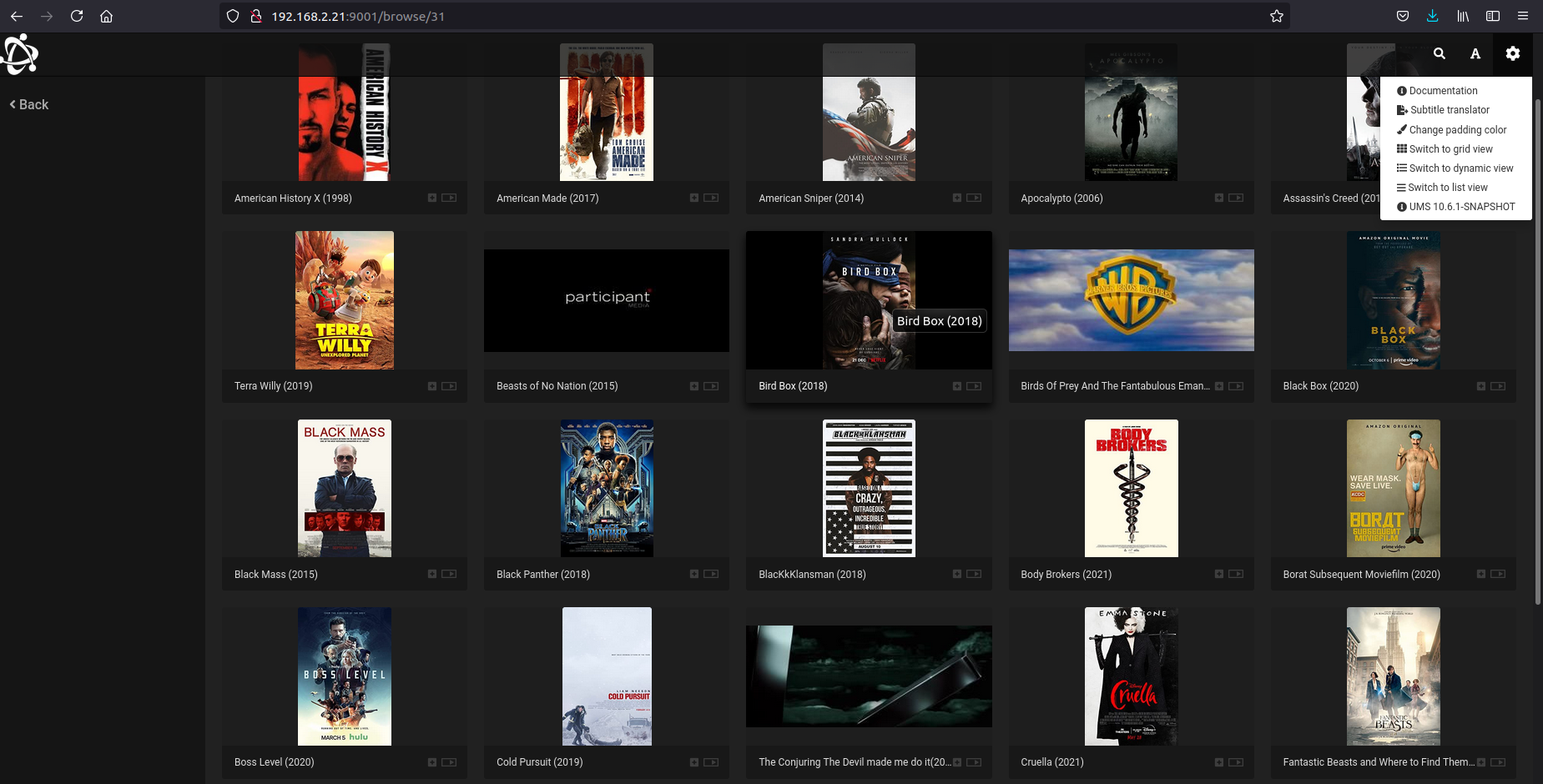

is it just me or does getting movie covert art really lack for Universal Media Server? Ive been transferring my movies on my Jellyfin server to my UMS server just because I really enjoy UMS but I have to say UMS's way of getting Covert art really sucks or i'm doing something wrong? I have a script that i run that prettifies all my Movie names so I am not adding in any special characters, i also remove the annoying 1080p from the string if i see it and Jellyfin picks up on just about every movie i put on, but UMS doesnt seem to pick up on like 70% of what I upload to that server.A lot of the most recent improvements have been around episodes and seasonal program cover art, but I dont see any mention on Movie art in general. Is this working well for everyone else?
here is an example of a movie that is perfectly renamed and I do not get any covert art for it
Assassins.Creed.2016.mp4

Thank you Valib, surrounding the year with parentheses corrected the problem for the vast majority of my movies, i have about two left but im not complaining its way better than before.

We are working on the fix. Can you provide the filename of movies whose are still not correct to be able to fix them?
Re: Movie Cover Art on UMS is lacking
Below are three more helpful examples, i added a few more movies to my UMS server, ill continue doing so in the coming days. For now Im just enjoying UMS with the Movies i have so far. Let me know if you need for me to run any tests. Id be more than happy to help.I'm running Ubuntu 18.04
Beasts.of.No.Nation.(2015)
Birds.Of.Prey.And.The.Fantabulous.Emancipation.Of.One.Harley.Quinn.(2020)
The.Conjuring.The.Devil.made.me.do.it(2021)

Thanks for reporting this, we are happy for the opportunity to improve the filename detection. Please try https://www.universalmediaserver.com/up ... embudo.tgz and let us know how it goes

here is a screen shot after using the build provided, not working quite yet, i tried removing the parenthesis and adding it again. I also cleared cache thinking the image itself is cached but nothing
- Screenshot from 2021-06-10 09-21-16.png (820.94 KiB) Viewed 70733 times
