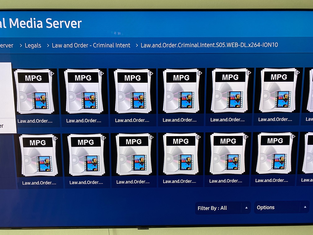

So I tested for a few days. It occurred to me that part of the problem might be thumbnail generation. I've attached a picture of the files (three of which I watched last night) that don't have any thumbnail generation; therefore UMS can't make it as watched. All the files in this folder (as pictured) are mp4.
- IMG_6848.JPG (256.9 KiB) Viewed 22328 times

UMS still makes (at least it used to) the "played overlay" on top of the "generic thumbnails", so I don't quite see how that could be a cause.

Is that not a generic thumbnail made by your TV or is it one UMS sends?

Re: Samsung Q9 series issues
@mik_s The "generic" thumbnails shown in the screenshot above are made by UMS.
