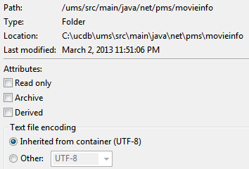

Re: MovieInfo
Line 39 of CSFDPlugin.java:
Correct one [UTF-8]:and wrong one [some ISO]:
If encoding is wrong, then plugin will not correctly parse text so different output for your new plugin and the old one? Only my 2 cents
title = title.replace(" | ?SFD.cz", "");Code: Select all
title = title.replace(" | Ä?SFD.cz", "");- Attachments
- Eclipse encoding
- Eclipse_encoding.png (7.68 KiB) Viewed 33097 times

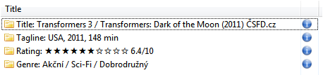

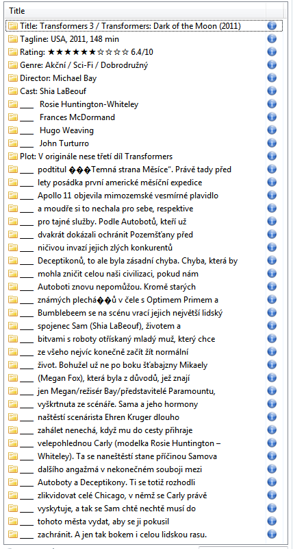

Re: MovieInfo
Here the difference (ignore bad chars... it is problem of eezUPnP, in XBMC chars are ok)
First one shows ?SFD.CZ in title name what should be filtered. And from "Director" none is parsed correctly so not showed at all?
- CSFD -Bad
- csfd-bad.png (6.19 KiB) Viewed 33095 times
- CSFD - OK
- csfd-ok.png (37.46 KiB) Viewed 33095 times
