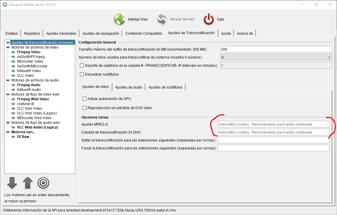

I just installed the 10.12 release and for some reason I can't modify the transcoding settigns, they appear greyed out. I Used to have 10.00 installed and was able to change those settings, any idea on what may be the problem?

UMS now does a speed test of each renderer and uses this to use the best settings for transcoding, so those options were disabled by default.

I'm not exactly sure but I think there is an option in the UMS.conf that will disable the check to set the best quality, I believe it is automatic_maximum_bitrate =
Setting this to false should enable those options but this will effect all renderers on the network instead of picking the best options for one particular renderer.
