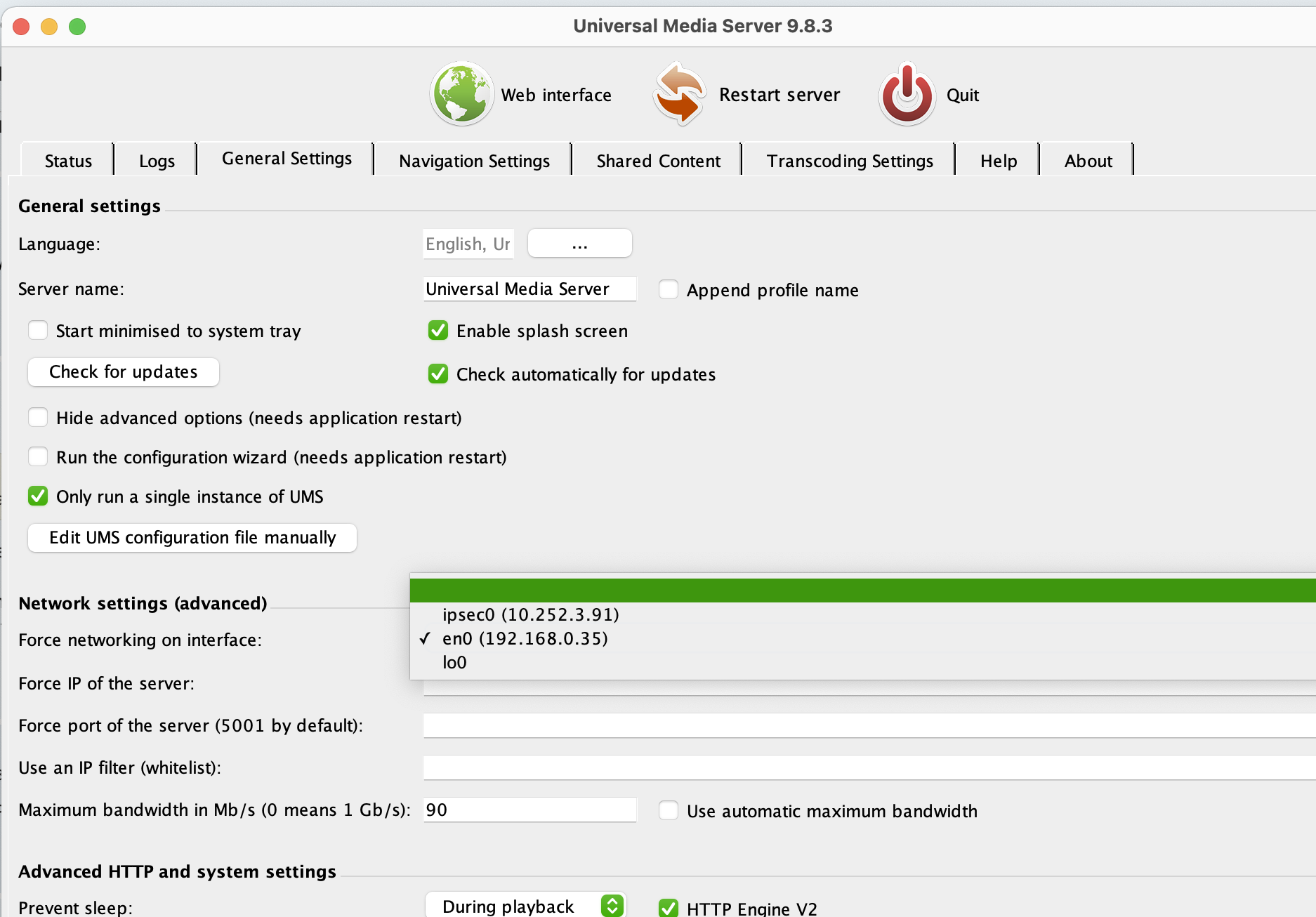

Well after a no problems for years, My Norton VPN had a huge update to fix VPN issues, and now UMS won't detect any renderers again. I have tried every option in the 'force' dropdown as attached. As well as disconnected from VPN. Any ideas?
Thanks...
Thanks...
- Screenshot 2021-10-24 at 22.29.10.png (289.45 KiB) Viewed 4517 times
Re: [Solved] New iMac....
Could you post logs? See the section above in red or the link in my sig.
