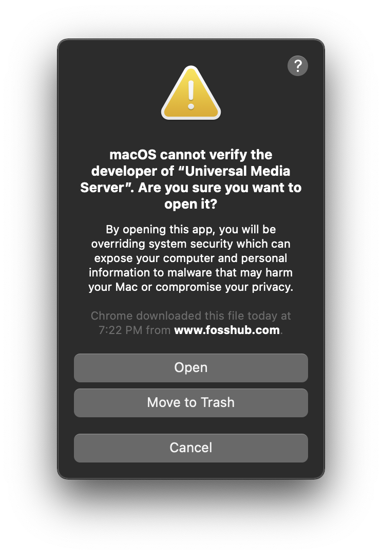

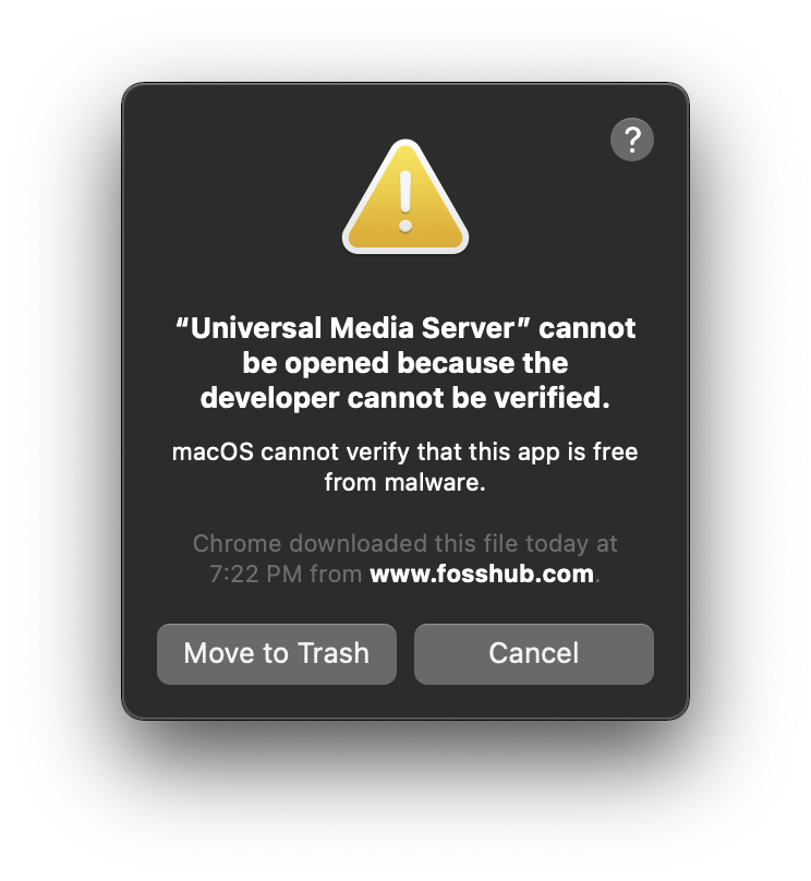

I'm running UMS on Monterey with Intel CPU.
Just to check. I redownloaded the UMS-10.12.0.dmg.
Mounted it and copied Universal Media Server to my apps.
Opening it or right-click-open the first time will show:
Cancel.
Then right-click-open a 2nd time and you should get:
Click Open and then subsequently it should open fine.
I've only seen damaged screens for when the update downloads from within the UMS app, which hasn't worked in a while on the Mac side. I always need to download it from the site.
