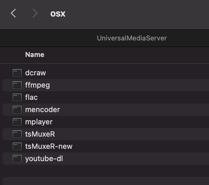

On my machine I had to set executable permissions and I thought that would cross over into the build but maybe it didn't. Can you try setting the permissions of the tsMuxeR-new file? Via the macOS terminal it should be like:
sudo chmod 755 tsMuxeR-new

I can't reproduce this anymore on my machine but maybe that's some kind of permissions caching thing. I'm trying to get access to another macbook to test a fresh install on.
What happens when you run that chmod command above? Does the icon change? For me it changed the icon of the tsmuxer files to black like my screenshot, while before they were a different icon
