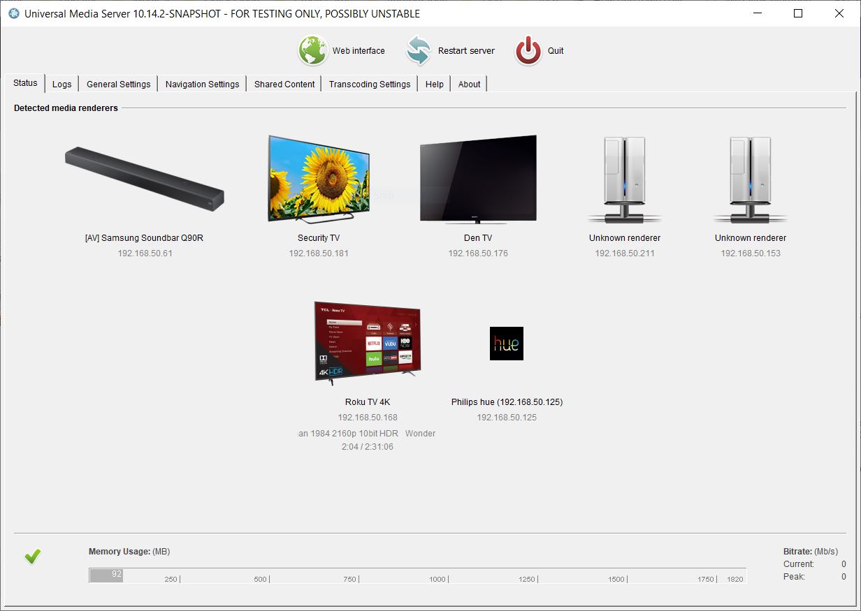

The 1080p and 4k tv's now showed up in UMS. I'll try the 3rd TCL 4k shortly.

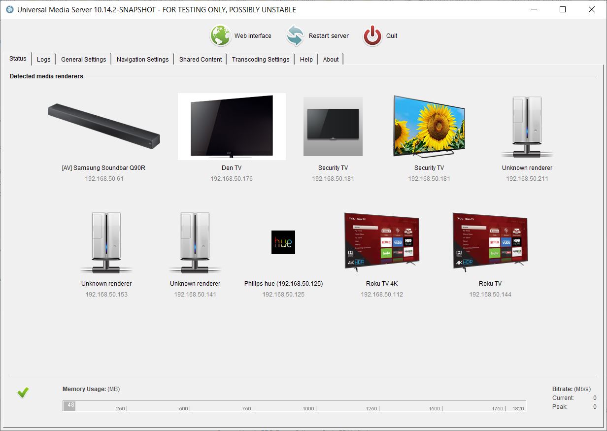

The 5 series TCL shows as 4k and streams just fine now....Meow meow!
Looks like everything works. Multiple bugs fixed. Wheeeee all work now!
