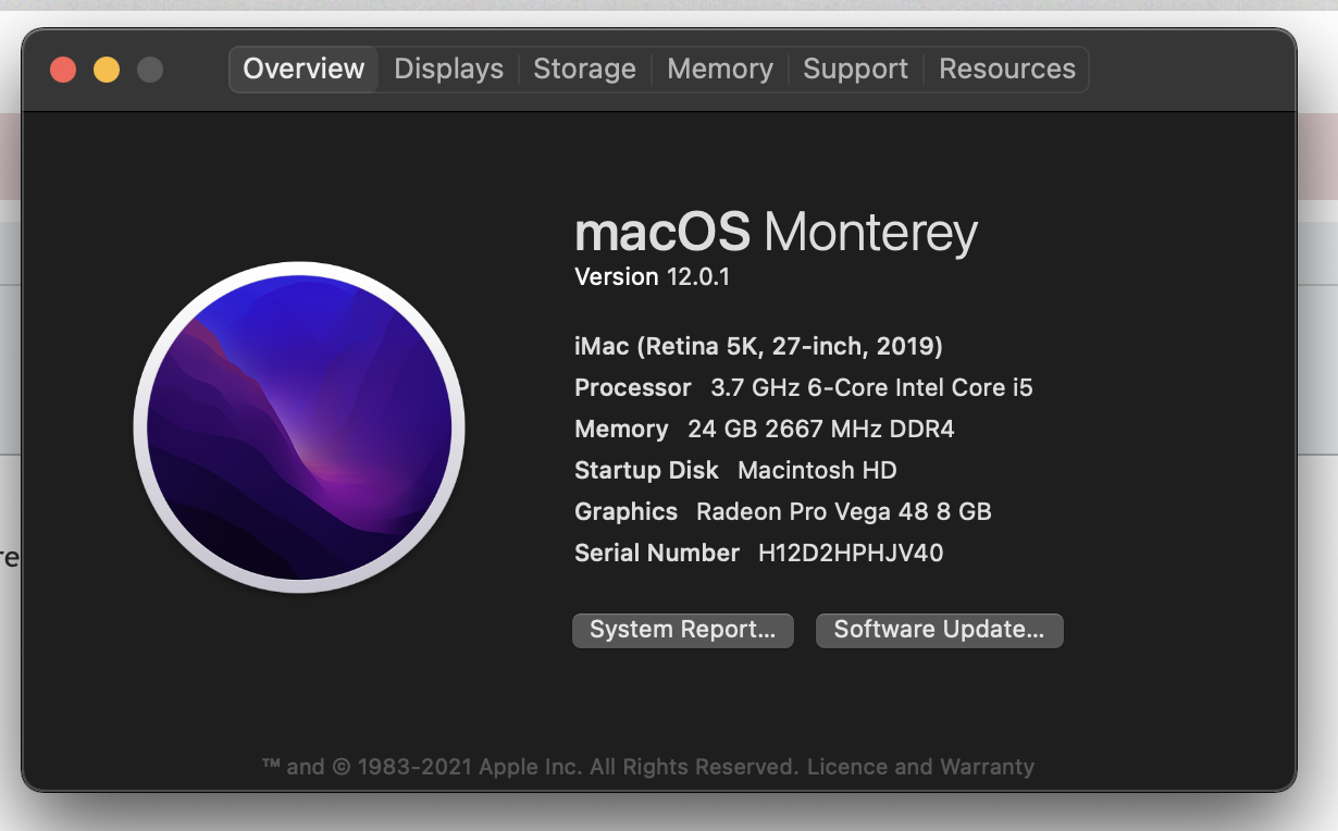

Terminal code of: sudo xattr -cr /Applications/Universal\ Media\ Server.app does not work either where as it did before.
IF I can just install and upgrade to the latest version, Im sure my freezing of gathering API will be fixed. Im currently stuck on 10.12. Any other ideas?
Screenshot 2022-04-30 at 10.20.29.png (295.86 KiB) Viewed 7869 times
