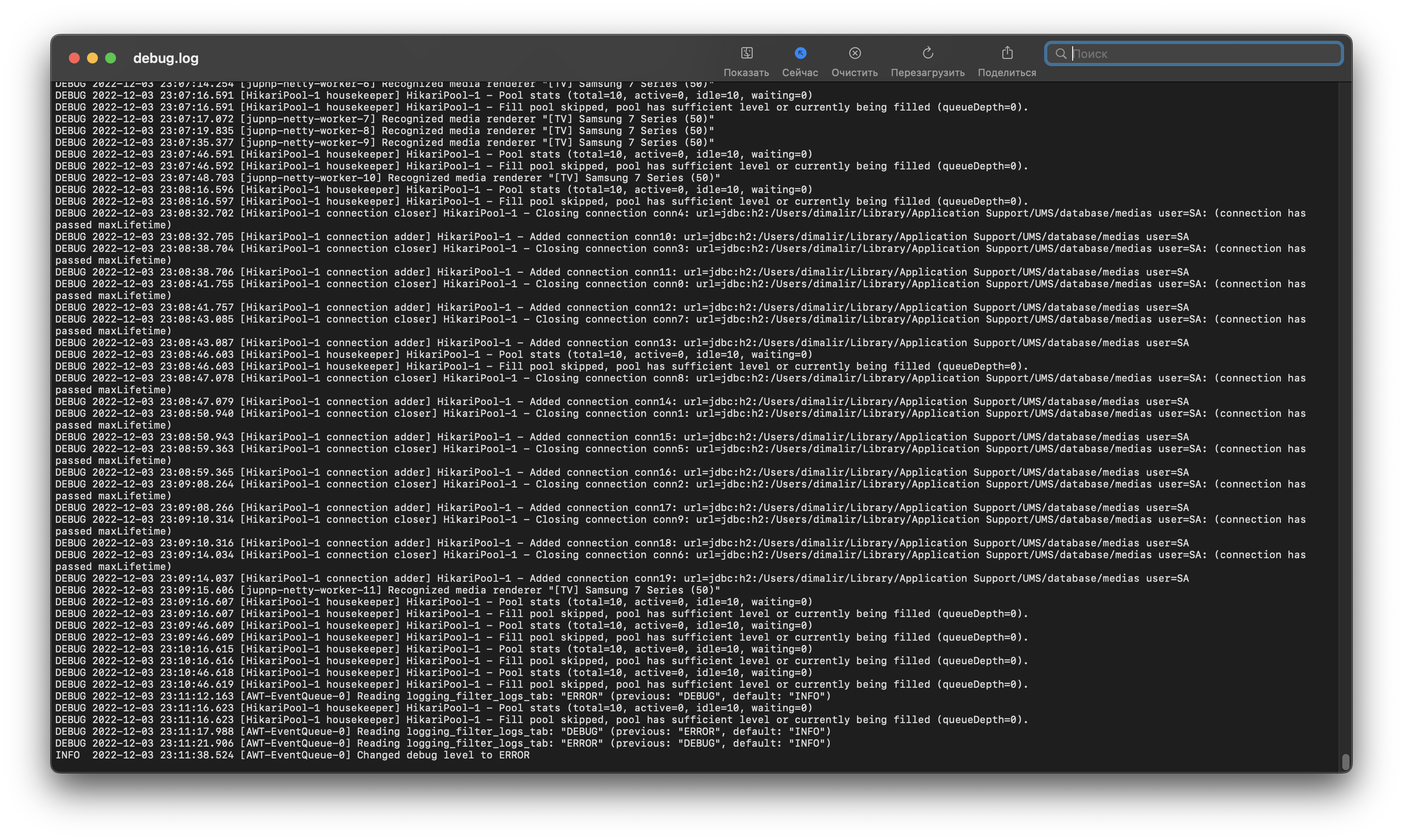

lirdm
Posts: 3
Joined: Sun Dec 04, 2022 5:37 am
Re: freezing video
Post by lirdm »
In attach.
?????? ?????? 2022-12-03 ? 23.14.58.png (1.48 MiB) Viewed 2567 times
Re: freezing video
A screenshot is no good and needs to be in trace mode.
Please follow the instructions in the red section and post the packed logs zip file.
