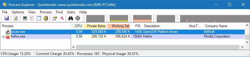

I use process explorer to replace taskman so its a little different for me, it shows javaw.exe using 529,888K private bytes but is using 298,548K in the working set
I'm not sure if taskman is showing the working set or private bytes though.
