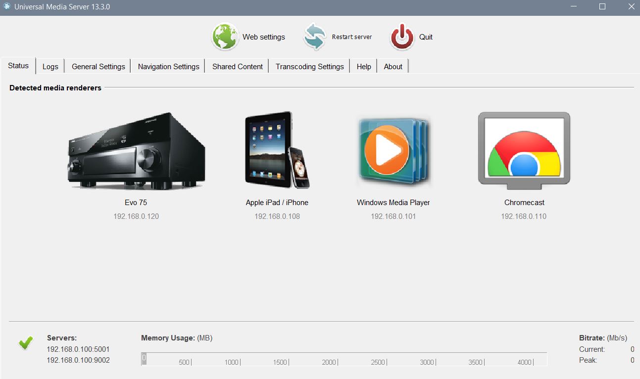

The picture (pic3) shows what I see in UMS.
For clarity, 192.168.0.120 is definitely the address of my Evo unit.
192.168.0.101 is my wife's PC, and is not relevant.
The device on 192.168.0.108 is not an iPad,but actually my Buffalo LS441D RAID/NAS running a Twonky-derived server! Might be nice to get a config for this too - but it always works for loading files onto my Evo.
The device on 192.168.0.110 is my android phone running the CA StreamMagic app. This is the app I use to enqueue, play, change volume, change source etc - unlikely to be useful, but the 3 screenshots in the SM.zip show how the app looks.
It does all look like coming down to config files, but I'm not sure how to proceed.... But it is weird that one-character change in a filename would affect whether a file can be enqueued or not!
As far as can tell from the Evo front panel, it reports all music files (FLAC or MP3) as being the bit-depth, sample rate or MP3 bit rate I expect to see - so UMS doesn't appear to transcode the data being played.
I do have a good relationship with CA (by helping many other users sort out their problems), and IMHO, if you can help to get the configs really clean, I'm sure we can get UMS recognized as a "supported" PC server. Which might be cool!

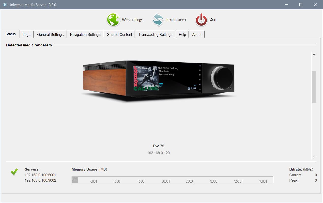

Additional info for anyone else interested.
I was able to get UMS to show the icon image of my Evo player (see pic "final.jpg"), as follows...
1) I modified the file - CA-Evo 75.conf - to remove (or comment out, for now) the line thus:
and added the line:
[.. can be any image .png file you like.]
2) Saved that modded CA-Evo 75.conf file in C:\Program Files (x86)\Universal Media Server\renderers (or wherever it is installed for others)
3) Opened the file "ums.jar" in the folder in C:\Program Files (x86)\Universal Media Server, with "WinRAR" or similar.
4) Navigated in WinRAR to "resources\images\clients" and drop'n'dragged the image file (e.g. Cambridge_Audio_Evo_7-small.png in my case) into that folder and saved/exited WinRAR.
5) UMS was not running during this process, which it should not be, but I restarted it, and it all worked.
6) I expect that updating UMS to a future version may overwrite the changes, so I will keep my edited version as "ums.jar.orig" copy, to save re-editing, and also a copy of the icon & the conf file!
Cheers!

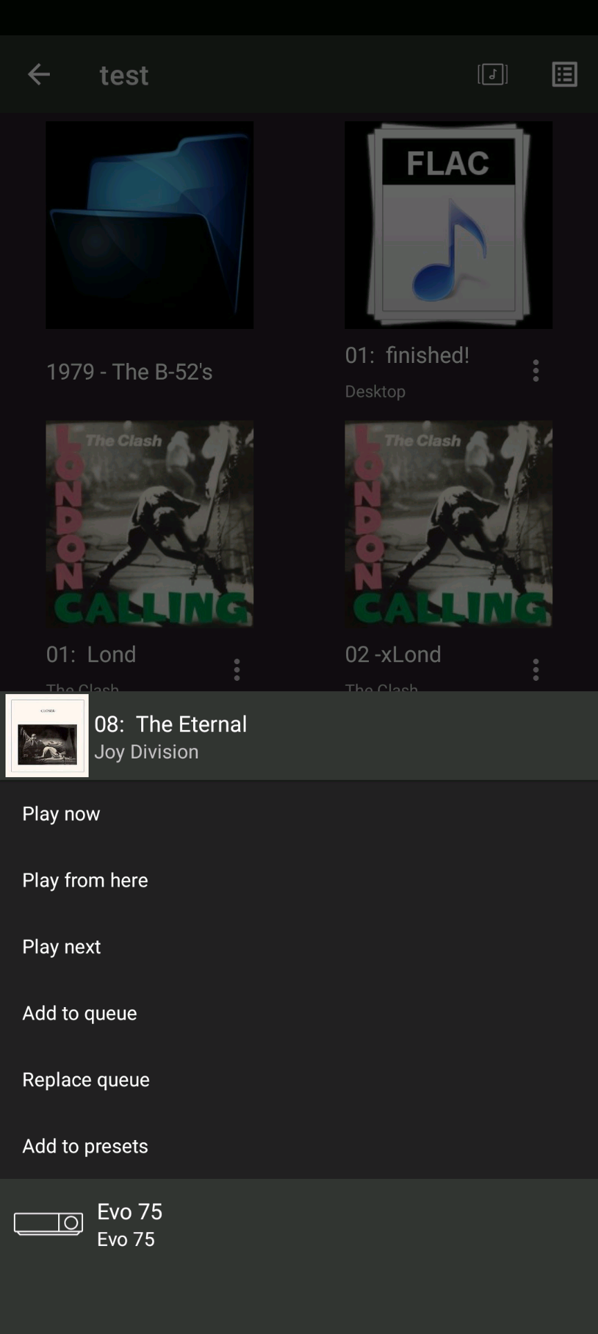

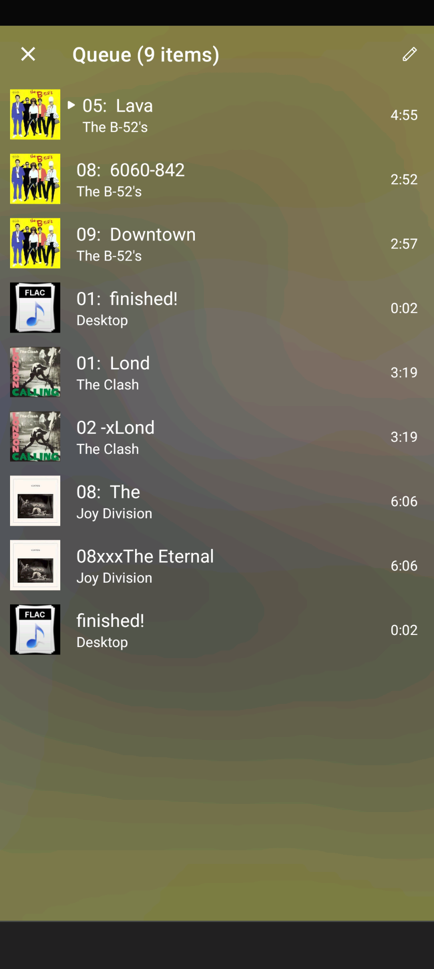

Aaargh!
So I tried a few more FLAC & MP3 files, and am still getting a failure to enqueue some!
In my test folder are the following 9 files, and showing which fail....
01 - finished!.flac OK
01 - Lond.mp3 OK
02 -xLond.mp3 OK
03 - London Calling.mp3 FAIL
08 - The Eternal.flac FAIL
08 - The.flac OK
08 -xThe Eternal.flac FAIL
08xxxThe Eternal.flac OK
finished!.flac OK
The files are copies from 3 basic files, just changing the filenames, and the Title tag (see pic)
Here are other files:
01 - Planet Claire.mp3 FAIL
02 - 52 Girls.mp3 FAIL
03 - Dance This Mess Around.mp3 FAIL
04 - Rock Lobster.mp3 FAIL
05 - Lava.mp3 OK
06 - There's A Moon In The Sky (Called The Moon).mp3 FAIL
07 - Hero Worship.mp3 FAIL
08 - 6060-842.mp3 OK
09 - Downtown.mp3 OK
It is not quite so simple as 8 chars and the sub-string " - " as I had hoped, and I am getting other results that make it hard to see a pattern.
Surely it must be a parsing problem of the files in the test music folder?
Is there a way we can escalate all this to someone who wrote the code, or is there more can done with the .conf file for the Evo?

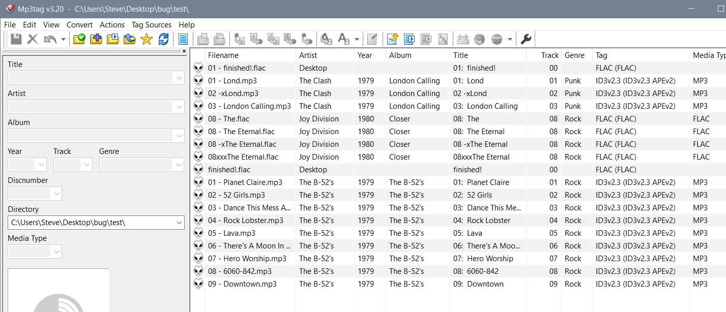

freemansteve
- Posts: 34
Re: Possible filenanme parsing problem.
Hi, I will get back to you with regard to the Evo images etc, but for now, I have the latest trace log attached.
- The files in the test folder that UMS scans are shown in "files.jpg" (a view from MP3tag) there are 18 files, with the B52's album in a subfolder
- In the CA control app, "StreamMagic", I choose the UMS server and click on the folder called "test" as before.
- in the test folder, I can see 9 files and the B52s subfolder.
- I open the B52s subfolder and click on each file in turn to "enqueue" the files.
- I then click on the other 9 files to enqueue.
- The screenshot "Screenshot_20230501-120553.png" shows which of those 18 files actually got enqueued (only 9), but the rest failed.
- If I select "add all" or "play from here" (as the SM app lets me do, all the files go on the Evo's queue and play fine - it's weird that only the "enqueue" option gets failures!
- Note that if you look at "files.jpg", my usual music files (like the B52s album) include the track number in the filename, like "01 - file.mp3", and also the tag "Title" includes the the track number in this form "01: file". This is because some media renderers (Evo included) don't pull out the track number from the tags, for the front panel display, so the simple idea of including it in the filename is useful. The ":" in the tag is only there so I can see where a media renderer pulls its data from, and is not really necessary (but changing this back for thousands of files is a pain; mostly copying to backup disks being slow!).
I think UMS went offline and came back a few times, from the SM app's viewpoint. It flickered anyway as I clicked on files, possibly SM getting confused by the "Failure to enqueue" issue. Not sure...
Let me know if there is anything useful I've forgotten to add!
- Screenshot_20230501-120553.png (217.19 KiB) Viewed 13147 times

- files.JPG (186.23 KiB) Viewed 13147 times

This is what UMS sends to your player.
I know litttle about this but comparing items 34 and 35, which are "02 -xLond" and "03: London Calling", they appear to be the same except for the filename with spaces replaced with "+" but I don't think that has any effect. As far as I can tell this looks correct.
My only guesses where the problem is either something I'm not seeing to do with how this is stored in the database or maybe it could be a bug on CA's side.
I'll make an issue on GitHub now as I'm at my limit what to look for. Hopefully the Devs will have a better idea.
Do these play otherwise without queueing? Do you have any other renderers you could play them on?
