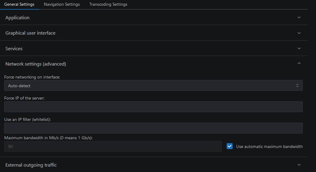

my renders are no longer showing they used to i have done a uninstall and a clean one removed from firewall and allowed to redetect even upgraded from version 7 to 13 srill same
they used to show had 4 in there
seems to be since java update
all default renders are turned on rebooted TV PS4
is there spmething in settings ?
Do I have to add into the router settings

Check to see what network interface UMS is using, try changing it and see if that works.
It should use the correct one if set to Auto-detect but sometimes VPNs can confuse it.
For anything else I will need to see logs (see the section in red above)
